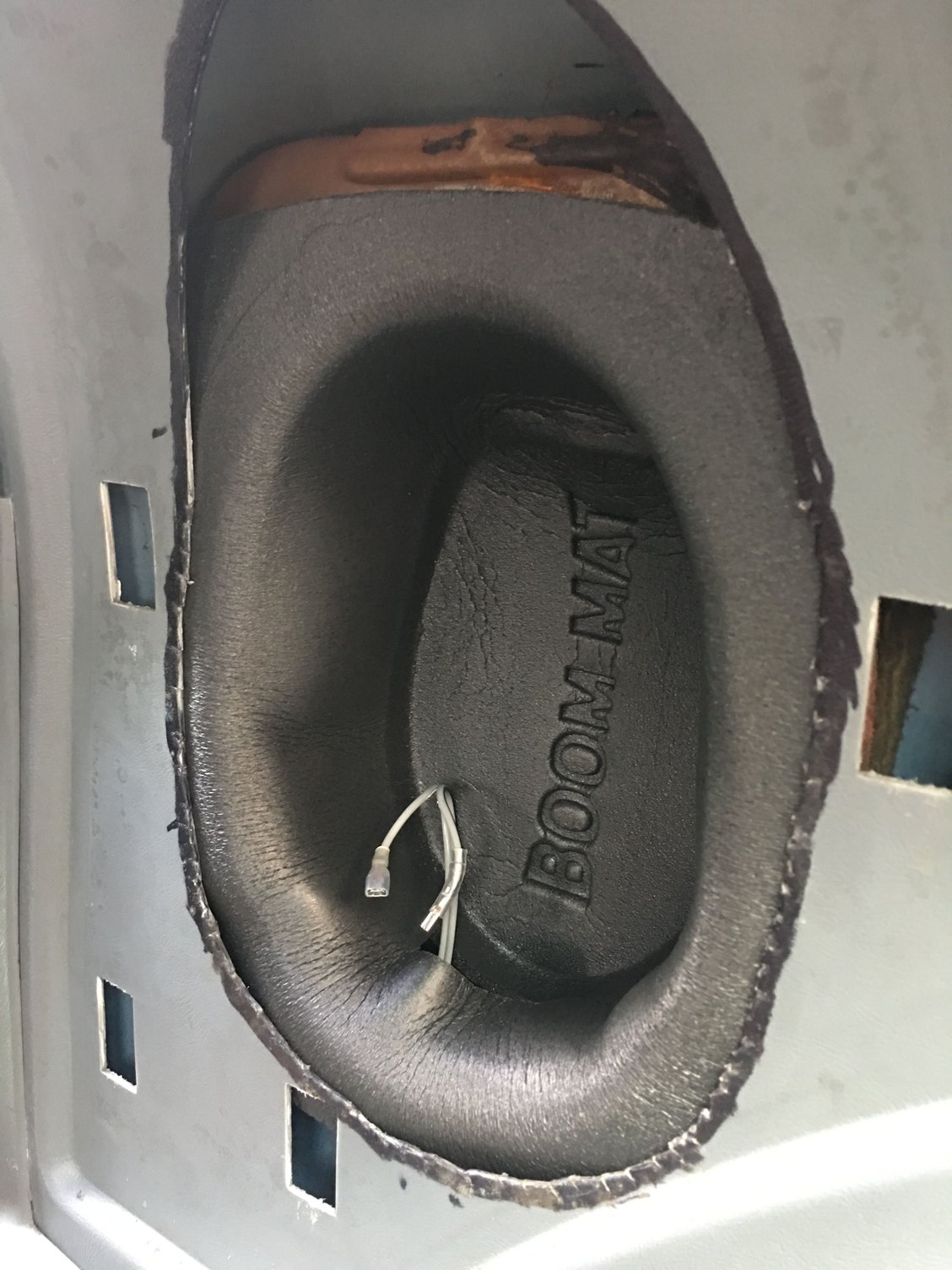

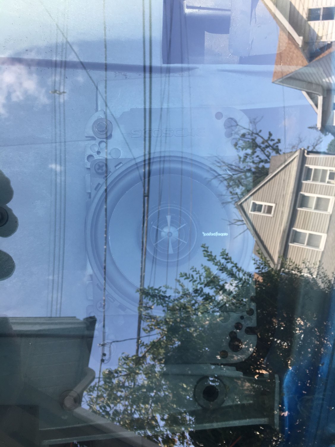

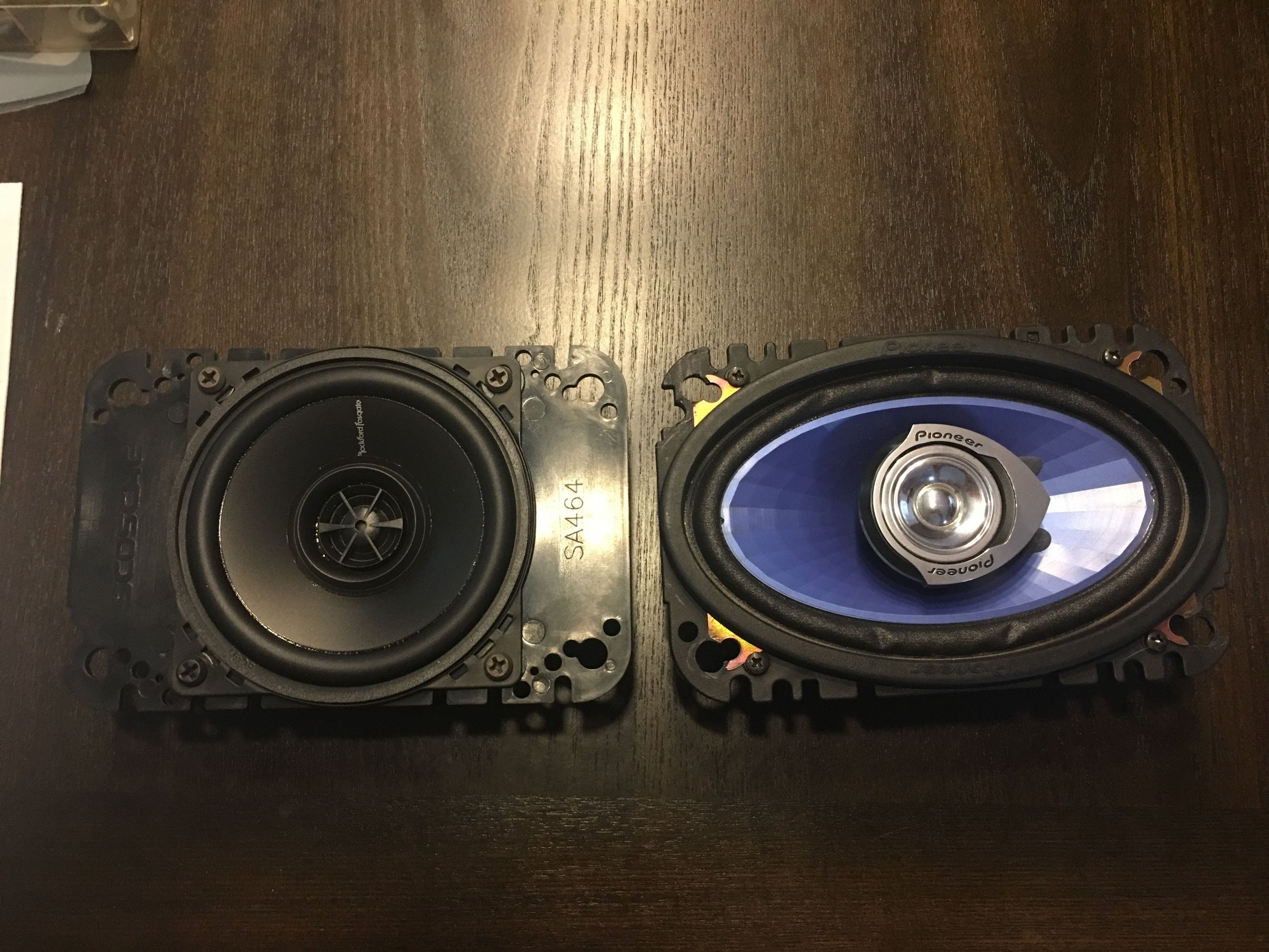

I’m on a audio kick right now. Decided I was maxing out the 10+ yr old pioneer 2 ways in the dash which had deformed cloth surrounds and had a 20w nominal rating. The new Sony headunit puts out a certified 20w rms per channel and I could hear distortion when I cranked it up. Crutchfield had a sale so I decided to pickup some new dash speakers. I got some Rockford fostgate prime 4”’round 2 ways and scoche speaker adapters and I got some doom mat speaker baffels for the rear 6x9s. The new RF primes have a higher 30w nominal rating and should be more efficient than the 4x6. I already wired in some PAC bass blockers before so it was a simple plug and play. The driver speaker was not as easy an install but it does fit with the air vent routing but just barely.
Installed everything and the boommatt in the backs and cranked it up, much clearer and the rear 6x9 now have a little more bass than before. But that’s why I have subs lol. The system is as good as it’s gona get now and I’m happy with it.

Very nice. I am not familiar with boom-mat, does it minimize vibration of the speaker chassis?

boom Matt helps with noise and allowing the speaker to be protected/sealed in the back. Think of it like putting a subwoofer in a sealed sub box vs just being open. I cut a hole in the bottom so it acts like a ported sub box in a way and increases the lowend on the speakers. They are louder with the ported boom mat than without and it was noticeable. Not a bad mod for $10.

Those Boom Mat speaker baffles look totally sweet. I've got some on the way now for both the dash and the sail panels.
