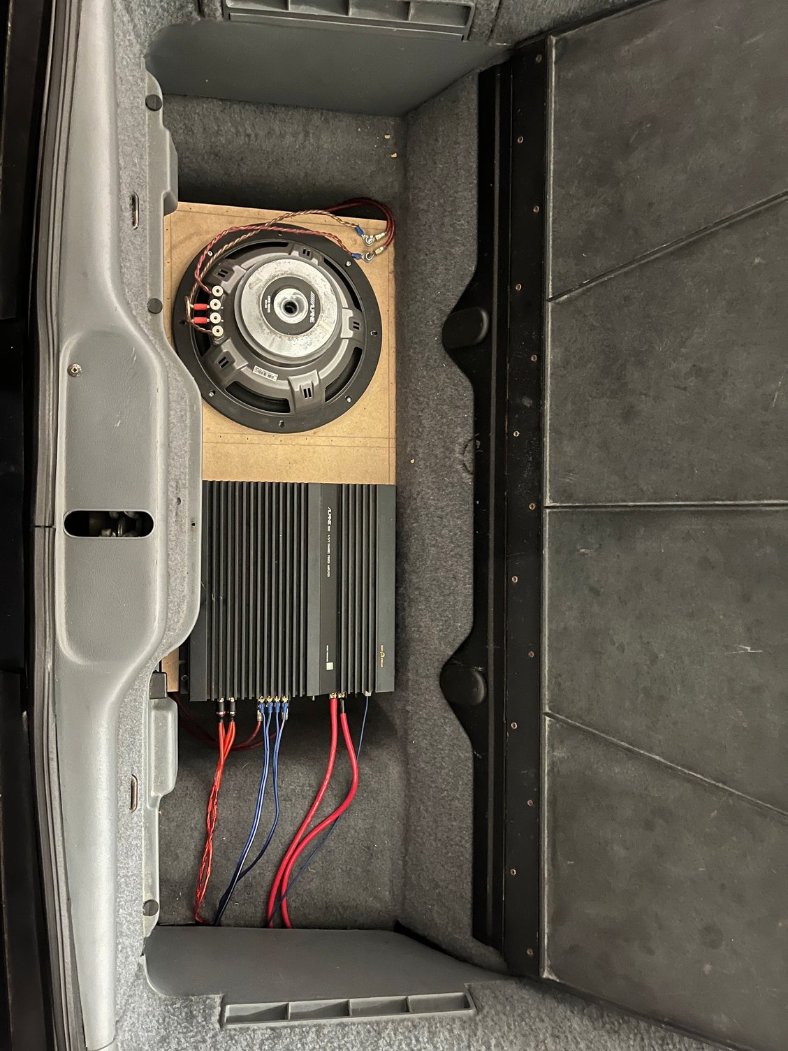

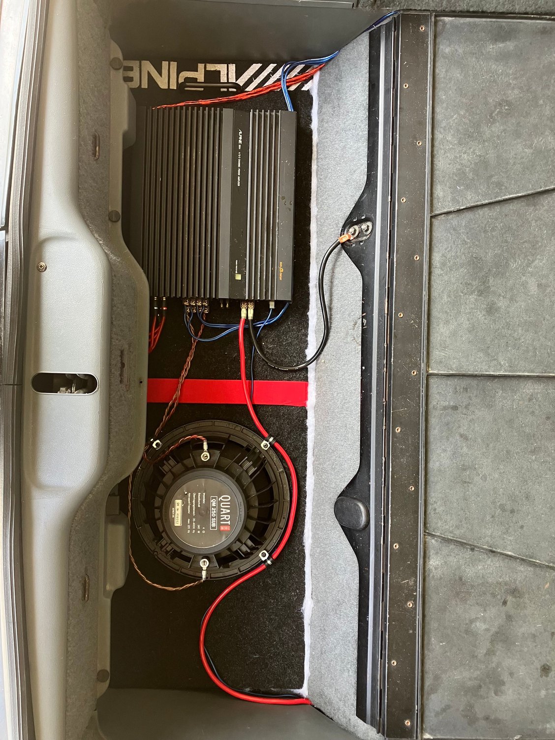

I’ve come to understand that (infinite) baffle boards were a legit “thing” for third gen f bodies. Literally a board of mdf or similar laid across the opening after the hump or in the trunk “well”.
pros:
Acoustically “flatter” curve than a full enclosure,
Lighter,
Much less expensive.
a few cons
Subsonics don’t play nice/potential woofer damage.
not every sub can be (or should be) in an infinite baffle.
More power required than with an enclosure.
fiber fill used to tuck in gaps.
For me even at low power output and a modest 10” sub this works well - I’ve already got notable tinnitus and I don’t need more, limiting the bass means limiting the front end as well and that’s only good news as I can’t stand music played into distortion.
My first effort, not the final. Mistakes were made. I could’ve been an 1/4” more front to back (the fibre fill will be required either way, just less). Yea the ground is lame, I know. I don’t want to order 25’ of new school copper clad aluminum ofc to use 4’. Holding out to find some old school stuff.

So your sub is pointing down into the well? Pushing the bass into the floor is what creates that "infinite baffle" concept?
I used a piece of MDF, made a shelf across the well about the height where your hinged cover rests on the rear interior plastic. But I cut a hole in it for my 10" sub on one side, which point upwards towards the glass, and I hung my amp on the under side, upside down, in the center out of sight. I left other side untouched for another sub, but I found that one 10" sub was plenty for me and my old school tunes, so I simply put another sub grill on other side so looks like 2 subs.
