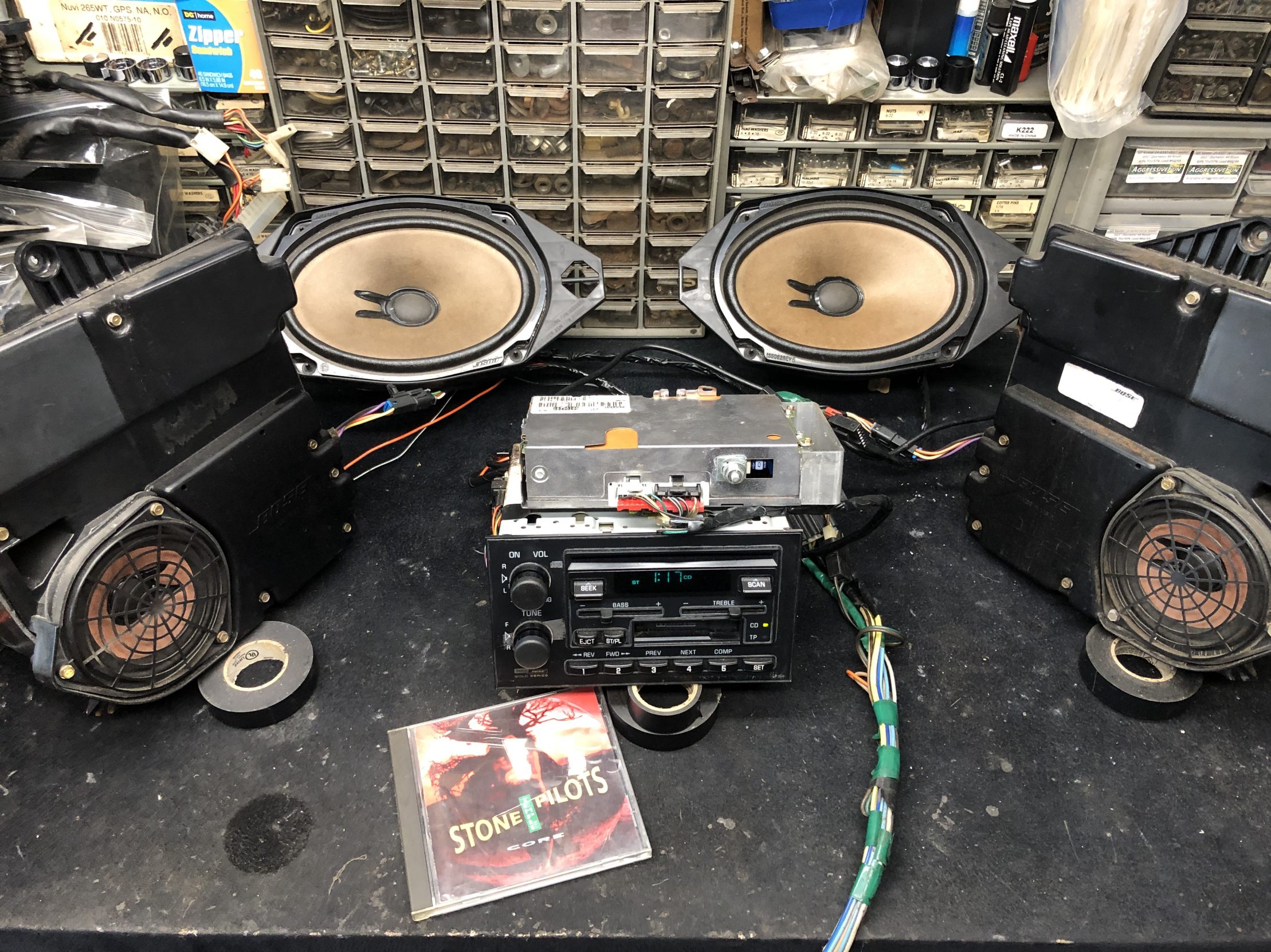

Ya',... I've done more BOSE work this winter than in all past winters, and that's sayin' something.
I just picked up this set-up from a 95 Caddy this week; 100% working set-up,....MUCH better condition than the "touch screen" BOSE system I got from an 89 Riviera a couple weeks ago !
I've got a pair of 02' BOSE 6x9's running 100 WATT Caddy AMPs in my 84 right now and they are a very nice fit with the rest of the set-up. I'm using the factory Berlinetta head unit and a signal converter so I've got 4 channel output control (not just F/R FADE) as well as an equalizer (over Treble/Bass) to play with. Just about every car I've owned ( except that dam Explorer
) has had BOSE installed. I installed a custom BOSE GOLD system into my 84 Berlinetta, custom installed the factory 5-speaker 95 Camaro system in my 95Z, converted my 05 Trailblazer from 'normal' BOSE to "LUX BOSE", and even custom installed a full BOSE system into my old 91 S10 Blazer. As long as you match a BOSE AMP to the proper BOSE speaker,... you can work wonders !
** I didn't install BOSE in my GTA; because that one has a factory restored "Performance Sound" system in it.
For future readers,.... I re-cap BOSE AMPs @ $45 each. The success ratio was about 80-85% till this year,... had about 20-25 AMPs this winter that couldn't be repaired so It's dropped to about 75-80%. ( & For the record; I did try to repair some UGLY AMPs and I did get more than that working again !!! )
I just picked up this set-up from a 95 Caddy this week; 100% working set-up,....MUCH better condition than the "touch screen" BOSE system I got from an 89 Riviera a couple weeks ago !I've got a pair of 02' BOSE 6x9's running 100 WATT Caddy AMPs in my 84 right now and they are a very nice fit with the rest of the set-up. I'm using the factory Berlinetta head unit and a signal converter so I've got 4 channel output control (not just F/R FADE) as well as an equalizer (over Treble/Bass) to play with. Just about every car I've owned ( except that dam Explorer
) has had BOSE installed. I installed a custom BOSE GOLD system into my 84 Berlinetta, custom installed the factory 5-speaker 95 Camaro system in my 95Z, converted my 05 Trailblazer from 'normal' BOSE to "LUX BOSE", and even custom installed a full BOSE system into my old 91 S10 Blazer. As long as you match a BOSE AMP to the proper BOSE speaker,... you can work wonders ! ** I didn't install BOSE in my GTA; because that one has a factory restored "Performance Sound" system in it.
