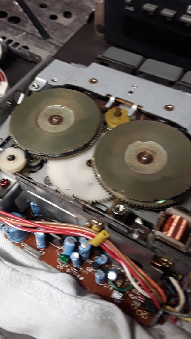

After many years of storage I went back to installing my original radio after my delco cd player(out of a Bonneville)quit. Turns out the cassettes wont play now but did when stored. Im suspecting the drive belt but is it necessary to disassemble the unit to make that call? ..the tape goes in and stays and play arrow lights up but the forward/reverse buttons wont stay in..only other thing is a light audible click noise..I believe my unit is the UT4 model if that helps.

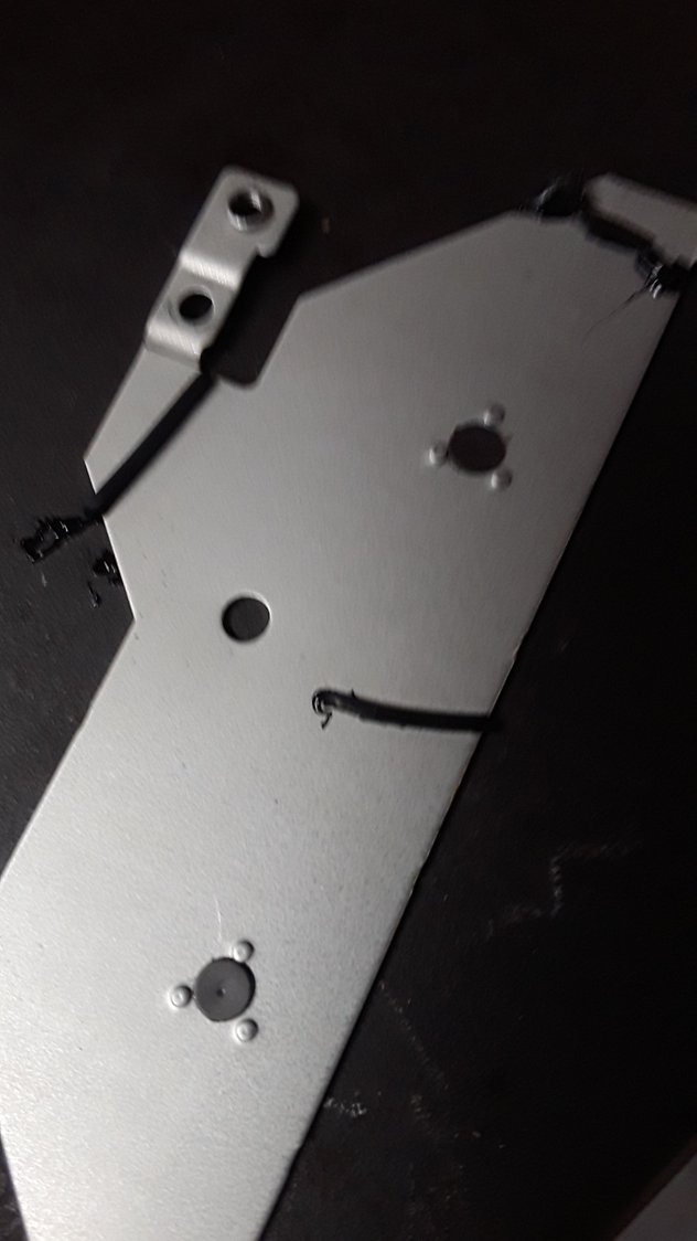

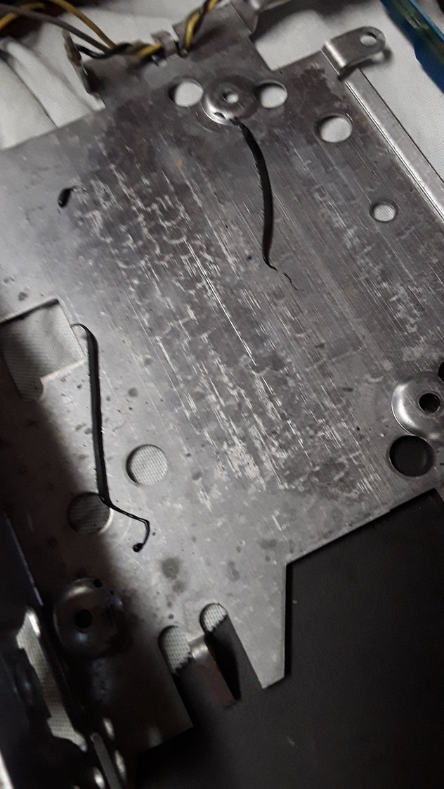

I decided to dive into the unit after watching a disassembly video showing how easy it is to get to these cassette mechanisms..And my drive belt was deteriorated..It actually had morphed into a substance that reminded me of "form a gasket "..pics below(crazy messy substance)..I have no belt to measure by so that I can order the exact one..Neither do I know the belt routing.
Anyone been in my shoes and have done the belt replacement?..I need a part # and routing diagram..TIA

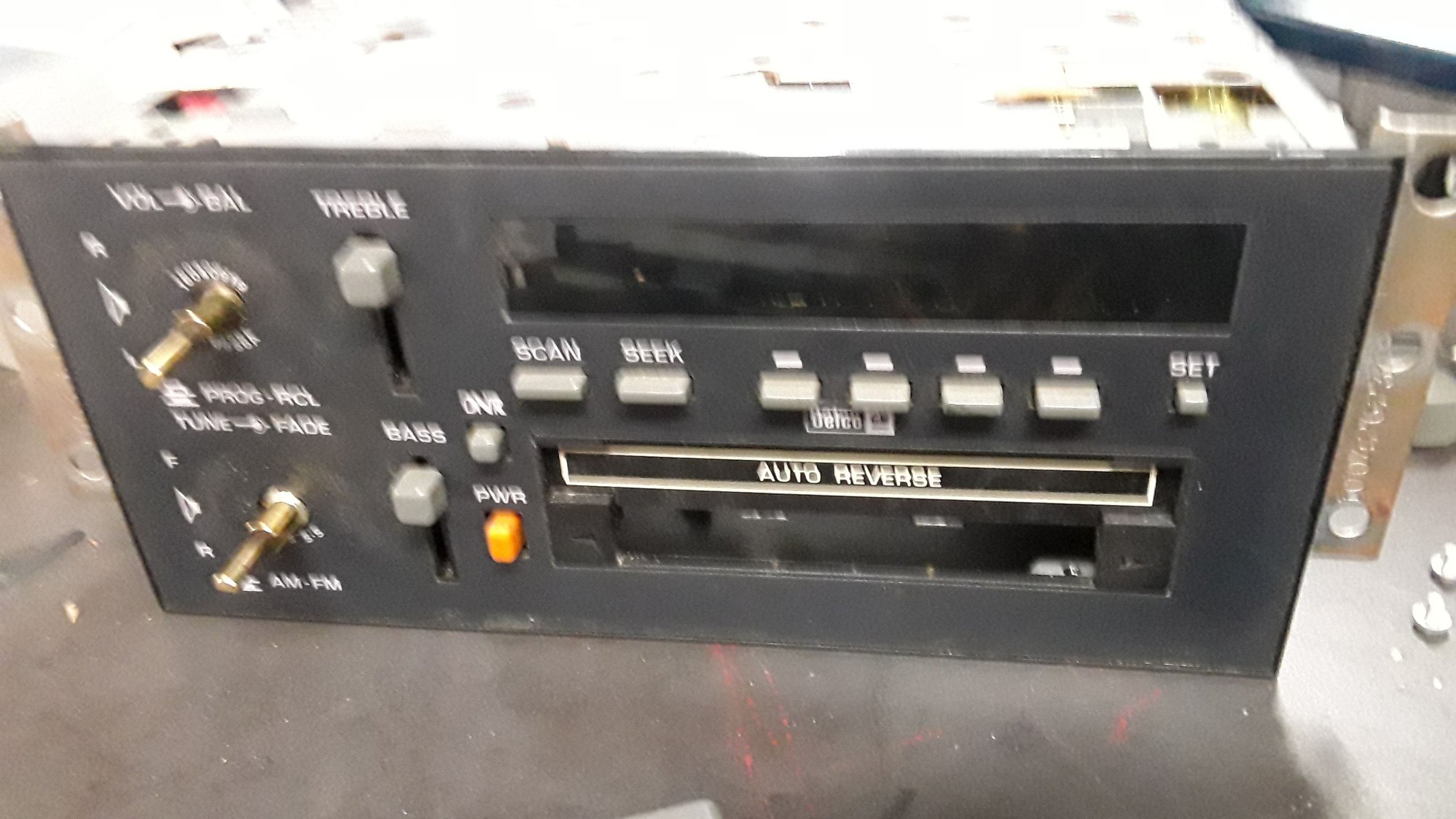

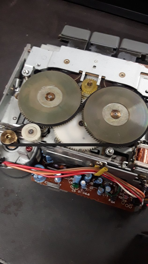

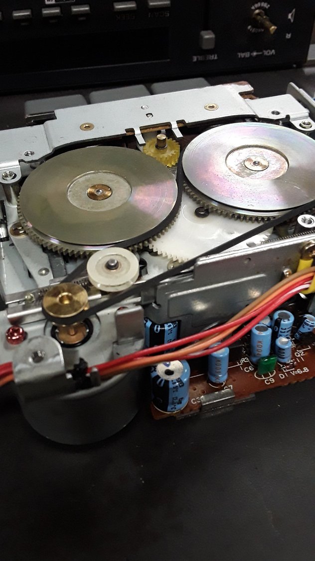

Belt arrived today and installed it tonight..Fits great and makes full contact on the pulley surfaces..I think the wall is thicker than what it should be be..What was left of my original belt measured at a 1/16" wide so I ordered the SCQ 8.62..
The thinner belt was a SCY 8.6 .048 wall thickness..Anyways will see how it plays cassettes tomorrow . Hopefully that was my only issue..Put up a pic to show you guys which delco deck Im working on..a 3 button Fujitsu deck I think is what it's called

I got it back together last night and installed it today..It plays just fine..forgot how good the old cassettes played thru those stock speakers..I do have another issue though with the auto-reverse. When I go to switch to side 2 it reverses fine but it doesn't always play the music and if it does play its only thru the right side speakers. So at the moment I have to manually flip the tape to hear both sides. I haven't a clue what that's all about and probably just gonna use it as is. If anyone has experienced that problem I would like to know the fix.
