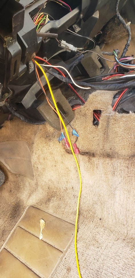

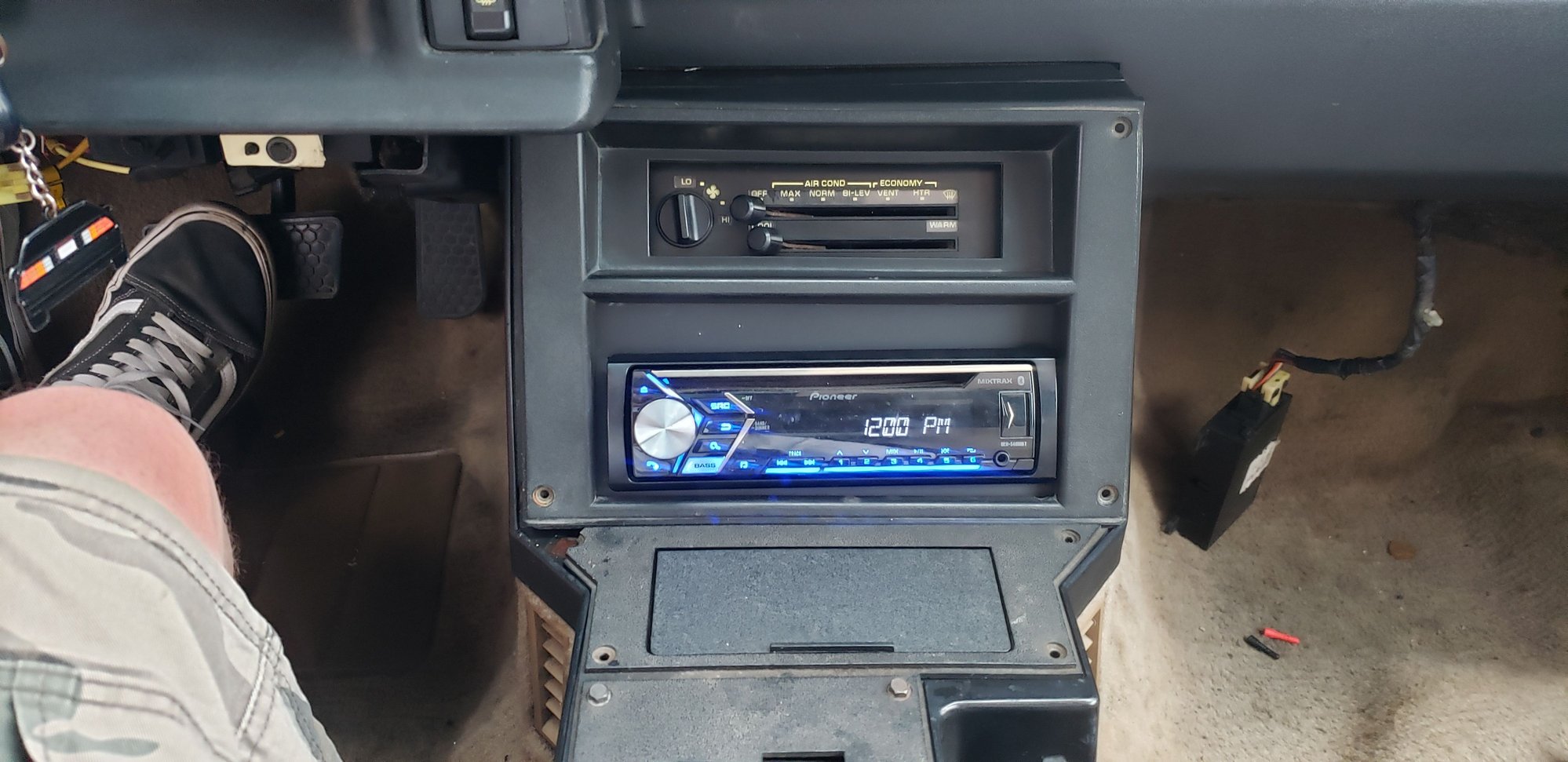

What started us looking into what the PO had done to the stereo was when I went to switch out the 6x9's and found his speaker wiring.
I saw these fine wires and that stopped all forward movement with any stereo stuff. After a full investigation, we are starting from scratch.
A full set of Chrysler speakers were found in the Camaro. I have a full set of Pioneer speakers to replace them with, eventually.
Fried white wire pinched in the body work. Not a fuse in the line anywhere.
That is one way to lower the ohm's the amp sees from the subs. The red crimp connectors are way to small for even one of the wires let alone 3 of them together. I didn't open them up to see what wizardry was going on in the black tape...
More garbage wiring. 8 gauge speaker wire split to become power and ground wires for the amp that was screwed to the bottom of the heater box in the passenger foot well.
PO's wiring has been removed completely.

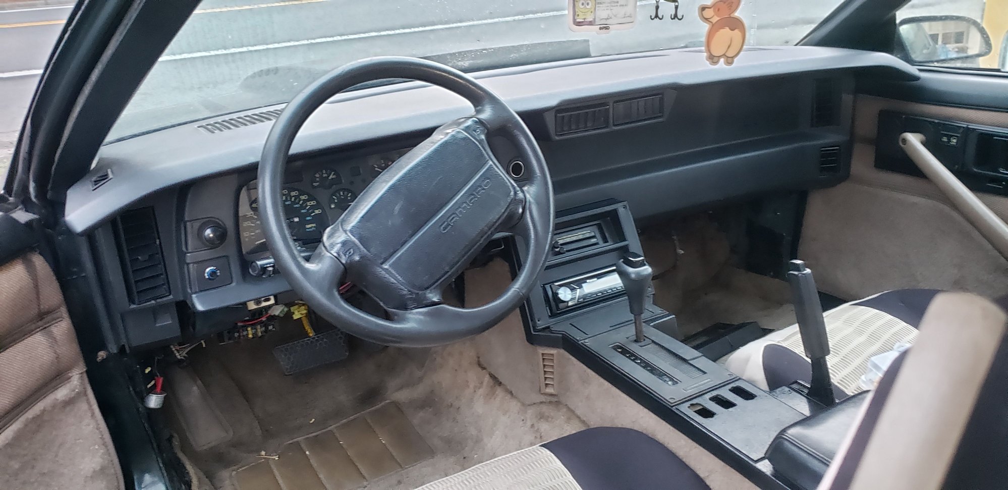

This is about where we were when the dash refurbish began.
All of the interior is out of the car at this point for a good deep clean and then rewiring the stereo.
After the new wires were run in the car we put the front carpet back in.
My son said there were maybe 5 fasteners holding the dash in the car.
At least it was a simple removal I guess...
This is where we left off, no dash.
Just a mess of stuff and things, but they all did get some cleaner and a wipe down.
So we are starting with a clean slate going forward.
Also notice the ability to see the heater core.

As of last night, the dash is nearly back together.
Just never mind the mess on the floor where the console goes....
Now we have the proper sized holes for speakers and all the mounting spots for the dash.
But in trying to clean things up, the VATS resistors were hanging out in the wind from a PO.
Tired to heat shrink them and one of the leads broke off.
Now waiting on a resistor kit from Amazon to get here tomorrow so we can fix the issue...

New dashboard is in and complete!
Just have to get some double sided tape so that we can reaffix the 25th Anniversary tag on the passenger side.
Speakers both have backing on them now with wiring and are fully screwed into place.
I forgot to take a totally complete photo of the project.

I got to have some time out in the driveway this weekend and I finished up the radio and console install to complete this dash upgrade.
I had to run a new yellow switched power wire from the fuse box as the PO had fried the wire coming straight out of the fuse panel.
I clipped it off and installed a new wire from one of the auxiliary power taps provided from the factory.
Everything has just been set in place for now as I have 3 more holes to drill to mount the **** for the Blaupunkt bass reprocessor that will be mounted inside the console.
Here the dash is now whole and looking much better.
I need to get some double sided tape to reinstall the dash badge.
The covers for the underside need to be installed, but overall it has had that part of the PO bubblegummery erased.
