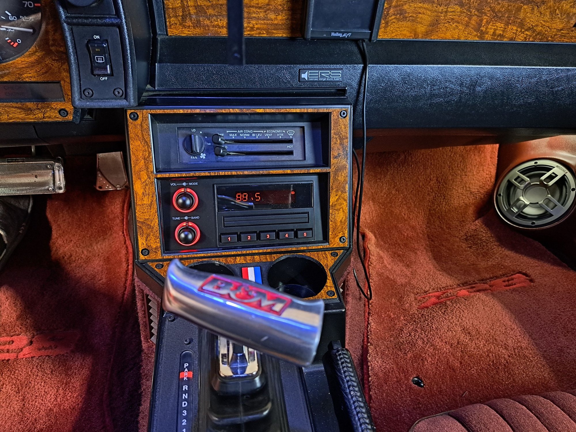

These radios from Retro Sound do have all the electronics. There connections that I personally do use so I tucked them out of sight but it has connections for Aux Jack to plug in your phone if you use your phone for music and it has Blue Tooth for your phone along with a microphone that you can put where you want. My car is a 1982 and the radio was a plug and play, I didn't modify my wiring harness at all. Here's a pic of my radio.
