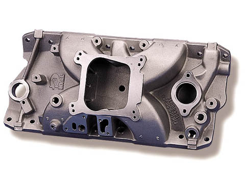

I got me a nos plate kit, and where going to mount it today. First problem I got was that I realized I needed an open pleum manifold. The dumb thing here was that on NOS's site, they didn't mention this fact, other that with the cheater's high power, the power was "so large a open plenum is reccomended."
Reccomended means not mandatory, right?
On the sniper, powershot and super powershot, all plate kits, none of this was mentioned, so I thought with some smaller jets on the cheater, it would be the same. But it wont work with a dual plenum at all, none of them.
Now I need an open plenum manifold for a Q-jet. I looked on ebay, at summit racing. None. Do it even exist?

I went thru scoggin dickey, ebay and summit, didn't find any, although it might excist... came to think of some of those dual pattern manifolds, they should work, only I can't seem to locate any with an open plenum.
No you see the bar across the intake plenum wich sprays the nitrous and gas, goes from front of car backwards, and thats just exsactly where the dual plane manifolds divide the plenum in two. Stupid me took it for granted that the spray bar went across sideways so the only part it couldn't spray was a small spot right above the divider in the middle.

5SiZ, do you have any idea if a plate system could be used with a dual plenum manifold like a performer rpm? I asked a NOS's tech, but didn't get an answer on that, at least not yet.
I was going to convert to injection this winther, that's why it was a bummer to have to buy a new manifold now. Not sure if I even are going to, perhaps just sell it and spend the money on something else.

Thanks for the part number on the wiand team G. Now if I could only locate a good used one i'll be set.
I'll refrase the crack dealer part to "try to stay on topic" the next time.
