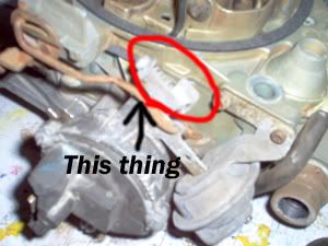

Ok. Just to clarify what I was talking about before...
Most pointless screw ever?
Old Jun 27, 2005 | 05:51 PM

no, I explained that...
oh, finally, that screw on your vacuum break/vacuum can/whatever you want to call it: That ONLY (someone can verify this...) controls how far the choke air valve opens after first starting, and effects cold idle ONLY. If you "tighten" the screw, (I think), when you first start the car, the vacuum can see vacuum, and pulls in the linkage that holds the rod, the screw pushes on another linkage, which pulls open the choke air valve.... best way to adjust this is.... NOT TO MESS WITH IT!!! however, if you're like me, you've turned the screw out, and forgot how it was.... when you reassemble the carb, the choke air valve should be closed, push the linkage in (you'll feel you're pushing air through it, it'll have resistance..), and push it in all the way, and you'll notice it'll pull the choke air valve open a TAD.... (1/8"-3/16" drill bit should fit in, barely...) There is a "spec" on your rebuild kit, it's an angle measurement, but the drillbit spec is easier and will get you in the ballpark.... Fine tuning is done by:

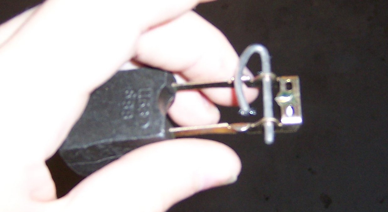

It starts up terribly now. I got some help from five7kid on adjusting it, but it was still messed up. There might be something else wrong in there, around the secondary lockout linkage. Warm, it starts fine though.
My big problem is shifting. It powers right through to redline, but then when it shifts it bogs for a second, then picks up. It's really annoying to be pushed back in the seat, and then lose all forward acceleration and have your face slammed into the steering wheel...

As per that PM, here is how the need should attach to the float.....
