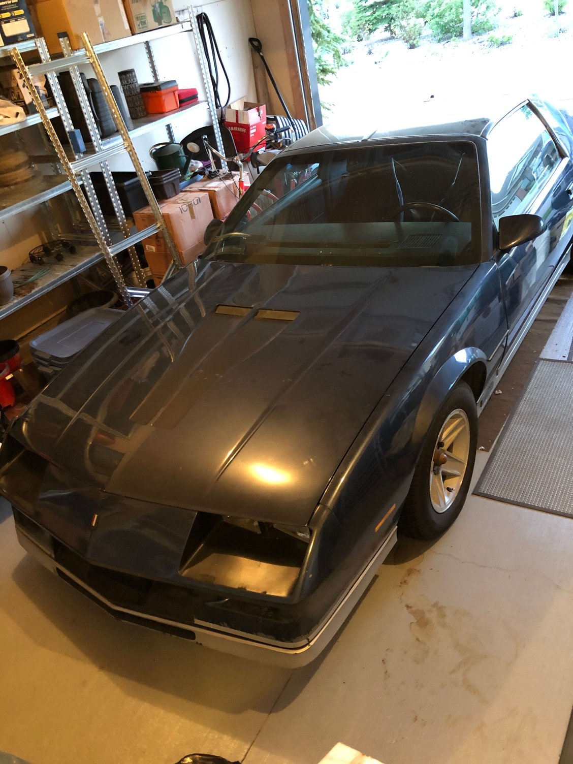

Hey guys I recently inherited an 83 Z28 with crossfire injection. The car has been sitting in my grandfather’s garage since 2004. As such the fuel pump is shot. I got the car hauled to a reputable mechanic who has experience with the style of car. ( he had an 82) he pulled the fuel tank and said its shot and the sending unit is to as well as the pick up tubes and screen. I can’t seem to find parts anywhere for this car and really don’t want to give up on it as it is great shape other wise and only has about 62 thousand miles. Any help would be awesome. TIA!!!

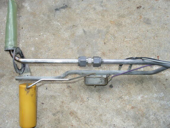

Originally Posted by pondriver
Since no one has any good information. Tell me why this won't work.
Before:
Attachment 447416
After:
Attachment 447417
Why do you need to bend the tube at an angle? Why can't you just use a straight piece of tubing and slide the sock up the tube so it's vertical? That's the way these types of sock style strainers were originally installed on the sending unit tube. Also, why not just use a short section of 3/8" fuel hose held on with clamps to connect the new tube to the sending unit tube instead of the compression fittings?
