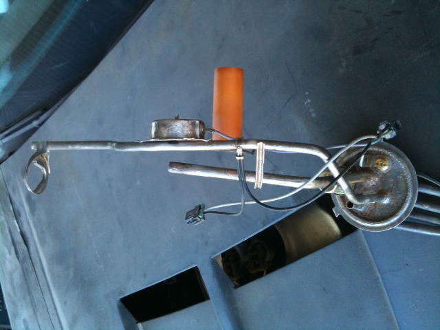

So my fuel pump went bad, thought it was just because ... but when I pulled the fuel sending unit assembly yesterday, discovered this
So I decided to start cleaning it, because a brand new one costs 189 dollars.
Fuel issues but also updates-cleaning3.jpg Fuel issues but also updates-cleaning4.jpg
How did it happen this way ? Left the car at the shop for way too long with very little to no gas in the gas tank. The gas tank it self has the same rust just on the very inside of the pipe, so I'll scrape that off, and flush the tank.
After that I can finally install the Walbro 255 pump.

Thats a lot of corrosion. Might be better to spend the money and get a new one. At some point, it could develop pinhole leaks, or even break.
Was there any water in the tank? It looks like it sat for a long time, and had condensation issues.

Sat around lol for yeah quite a while, each time I came close to starting the car I got sent on a deployment lol
I think it'll be alright now, still need to flush the gas tank.
But yeah when I pulled it put I went like ooohhh **** lol

If it was me, Id replace it with that much corrosion. Especially at the top where the brazing is. If it continues like that, the pump could actually fall off, or leak bad enough to drop the pressure.

Actually once cleaned up it doesn't look that bad. Seen much worse on ships, actually in reality never seen corrosion like this, where once cleaned up it's actually thick metal remaining, I'm used to metal being all gone when my guys sand away alot of corrosion.
True I'd love to get a new sending unit AND gas tank, but money's getting short and I need to save money for Trick Flow heads, rering kit, and whatever I need for tuning, like EBL or MAF TBI. Was almost going to get a kit on craigslist but pistons were with valve reliefs so wouldn't gain any compression but maybe even loose some. Yeah will need some guidance regarding what to get for a small engine build up.

Ok, decided to get a fuel cell after all. Connector on top of sending unit is broken, which is why I had no power to the new fuel pump, plus gas tank was rinsed but it's not in the best shape after all, plus I have other reasons.
