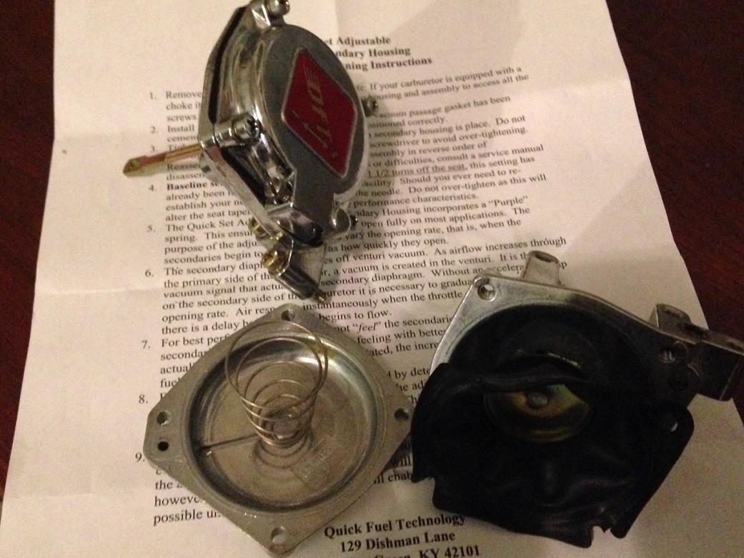

I went ahead and ordered the adjustable one in the link above yesterday. I'm hoping to only pull it off once, and this looked like the best way to go about achieving that.

So I ordered the adjustable secondary from Holley (QFT) and it looks to be a quality piece. I also went ahead and took off the old one and popped it open and it had a silver spring in it. Thats a mediocre spring on their chart so it should have been opening anyways. Further reading about it however reveals it should have a checkball with a slot in the ball seat. Mine does not, it has a brass plug with a hole in it...weird
Oh well, Installing the new adjustable one now and will update on the ease of use and outcome.

Results are in. The new adjustable housing comes with a "purple spring" and couldnt be more accurate for my application. No adjustments were necessary, though adjusting it is a simple turn of a flat head screw to make the secondaries open faster or slower. Secondaries are now kicking in at about 3/4 pedal and the car just pulls hard after that with no ill exhaust smells. I'm guessing they never fully opened before because there is a HUGE difference now. I may test it by 1/4 mile speeds, but I dont think its necessary. Its running superb.
