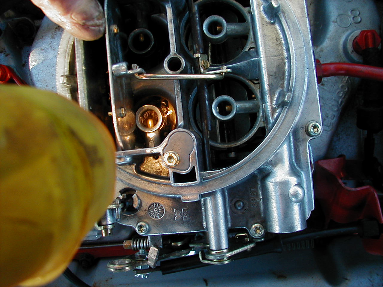

I've learned that Edelbrock carbs almost require the use of a FPR,...... if the fuel pressure is too high then fuel can/will push into the carb. This picture was taken after shutting off a car with a ( Fresh, professionally built ) Edelbrock Carb without a Fuel pressure regulator. You can clearly see the fuel is still pushing/filling into the carb even with the car not running.

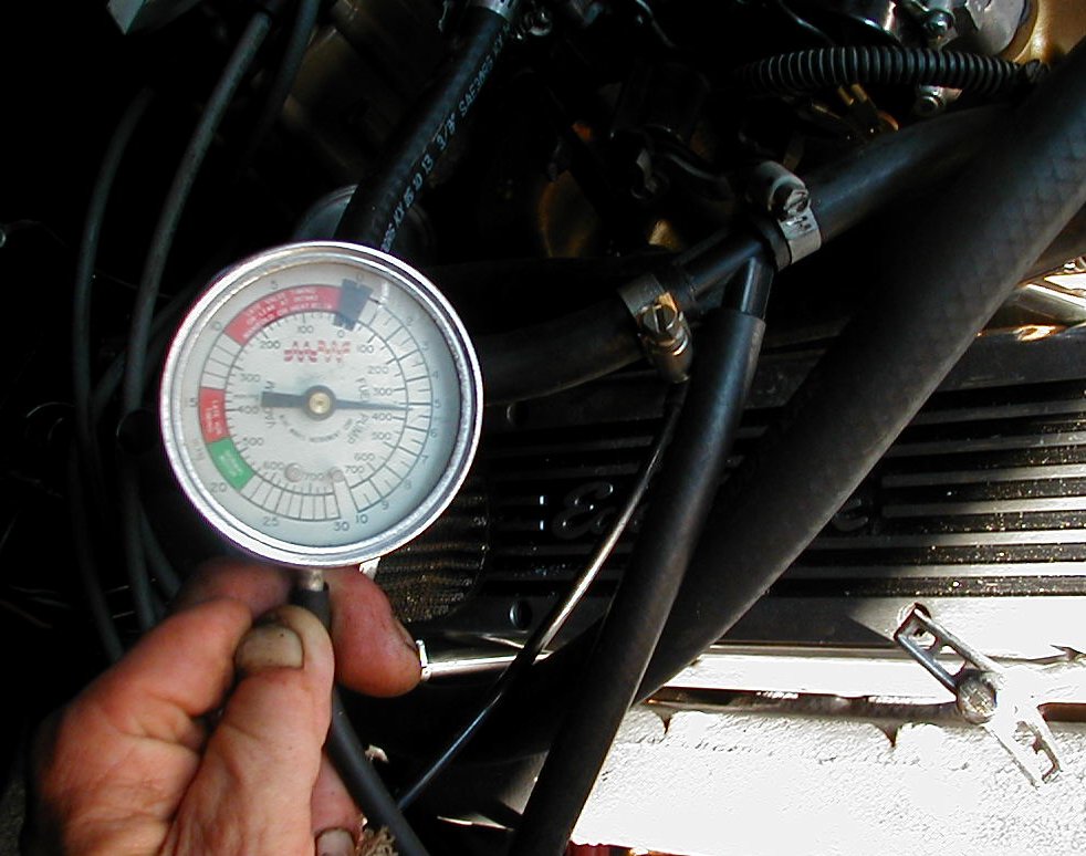

This is how I ran the last carb/regulated fuel flow to an Edelbrock SCB that I built using a factory style fuel pump. ( Don't buy cheap parts store fuel pumps,.. they have a weak lever spring in them that can cause a audible "Click, Click, Click" every time the pumps lever moves up and down - matching engine RPMs. ( sounds VERY MUCH like a lifter tick or a cracked flywheel !)
* note; I used a dead temp gauge sending unit as a plug on the FPR return port. If you use this type of set-up,... use a real plug !
Once everything is installed just dial in the FPR till you get good readings and you should be G-T-G !

I think the Edlebrock carb with the fuel dripping after it's turned off might have a different explanation, that being, the fuel in the pump boiling, from the heat of the block.
This problem has ZERO to do with under-hood heat.
I already knew what the problem was when I took the pics; it's not the first - or the only - time I dealt with it. Started working on it first thing in the morning on a cold car,... started it long enough to kick the idle down, shut it off, and took the pic to document the issue. Problem was gone after the FPR was installed; never to be seen again.
Here's another pic of a different car with a ( pro rebuilt ) Edelbrock,... Look familiar ??
The cheap parts store pump was making almost 9 pounds,... and the Edelbrocks simply can't handle it.
