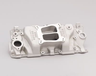

Ah yes, the Performer RPM Spreadbore. Better choice.
Much better chance of closing your hood.
I've always thought about this intake.
I wonder how it compares to my Weiand 8000 in terms of performance. The Weiand 8000 has the same runner design as the Weiand Stealth 8016.

I LOVE Weiand STEALTH intakes. I have stocked up on them.
I call my 8000 a "Baby Stealth".

Re: is there room!
The cool thing is the Weiand 8000 has bigger exit ports than the 8016. Matches up pretty good to my 200cc RHS heads.
And with the 8000 I have a mock EGR showing, and it fits under my hood with a dual snorkel air cleaner.
