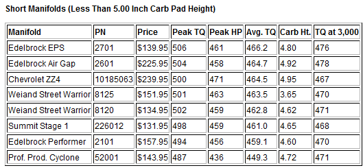

Here is what I have stored:
Old Jan 4, 2020 | 05:56 PM
HawkZ28's Avatar
Joined: Mar 2008
Posts: 557
Likes: 15
From: Lincoln, NE
Car: 86 Z28
Engine: Built 312
Axle/Gears: 10 bolt 3.42
Re: Intake Heights
NICE addition!
