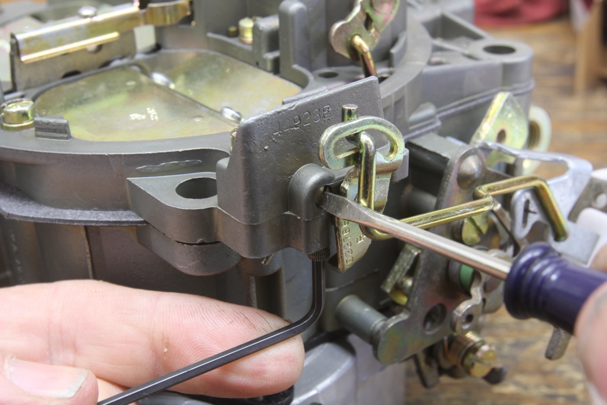

Correct, no adjustment... if the choke is on at all, the secondaries are blocked from opening.
The secondaries themselves DO have an adjustment however. it's that little screw just above and to the left of Paulo's red circle, in line with the air valve shaft. Underneath that, behind that black linkage, is a set screw, which is an Allen head, 3/32" IIRC but I could be wrong. Whatever it is, you loosen it, and then you can turn the screw. The screw sets the tension on a wind-up spring that controls the valve.
Most people think that letting out the tension, so that the valve opens easier, is good; but in reality that's the easiest way I know to get that "bog" at low RPMs where the engine makes a whole bunch of noise but no power. It should NOT sound like BUUUUUUUUHHHHH-WAAAAAAAHHHH when you floor it; it should accelerate crisply without hesitation. The BUUUUUUUUHHHHH part of the sound is the 'bog". Its setting is almost entirely dependent on the engine size, and independent of ANYTHING else. For a 305 it usually wants to be between 3/4 and 7/8 turn of tension.
Loosen the set screw, let the spring tension all the way out, turn the screw counter-clockwise until tension can just barely be felt in the blades, then turn it 3/4 turn more, and tighten the set screw. Tune from there for best results. If it has the "bog" (lean), increase the tension. If it blows out black smoke as the secondaries just start to open (rich), reduce the tension.
The air valve also moves metering rods that alter the mixture as the valve opens; and the rods are suspended by a hanger that determines how far into the jet the rods go, and the point where full richness is reached. That vacuum diaphragm on the side of the carb, which is primarily the choke pull-off, is also the damper for the secondaries, and controls the rate at which they open. All of these are further tuning aids. But that's usually not necessary or productive for a stock engine. Setting the AV tension correctly IS critical however.

Re: Quadrajet Secondary adjustment
Here's the air valve adjustment. The air valve opens due to manifold vacuum (air flow) through the secondaries and works against spring tension. The adjustment is to vary the tension in the spring which keeps the air valve closed; adjustment either quickens or delays its opening when the secondary throttle blades open.
In my opinion, unless you want an extended exercise in trial and error frustration, leave this adjustment alone.
