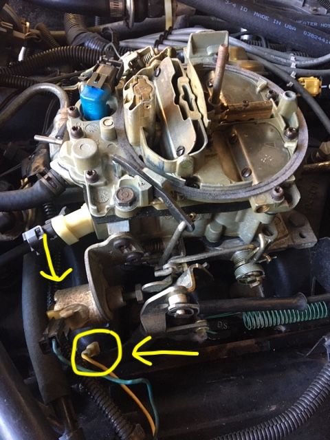

Hey all,
Had the original carb from my 1984 Trans Am 305 professionally rebuilt. I think it is the E4ME . (QuadraJet # is 17084205 on the unit)-pictured below. I had Two questions I was seeking your advice on:
1. Their is an 'extra' wire (yellow) coming from the same harness as the Blue wire (which connects to the Solenoid). It is just hanging their with no connection (or Male end to connect to). Any idea what this wire is for??
2. I want to replace the actual Solenoid itself. My local Carb shop wants $130 for this (seems very high). I want to order this online, but dont know if anyone has a vendor preference or part number. I am sure I can buy it online for less.

The yellow wire doesn't look factory to me. Trace it back and see where it goes.
I don't recall that solenoid ever being cheap. Might want to check Rockauto and the various other usual suspects such as parts stores. They almost never go bad though; in fact it looks like that one is working fine.

And yes, that is model E4ME... 4M = Quadra-Jet, the 1st E means Electronically controlled, the E at the end means Electric choke.
