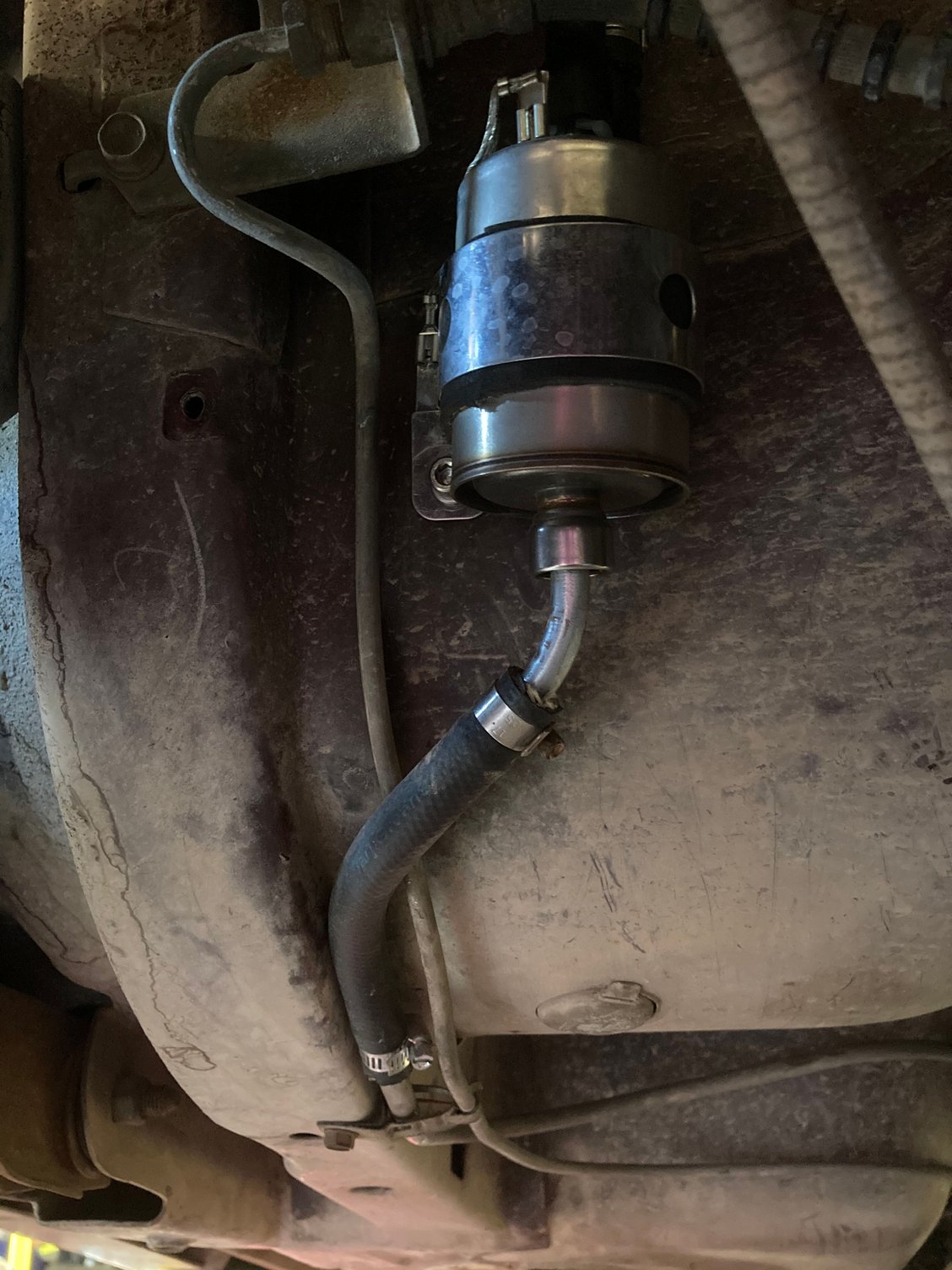

So I think I have a really dumb question here. The guy I bought the car from said they dropped the tank and changed the pump and added what looks like a summit LS regulator. I’m going carb and need to kick it down to 6.5 psi. Can I just add the new regulator where the rubber hose is downstream of the one that’s there or should I remove the old regulator altogether?

The picture you show is your fuel filter, not a regulator.
