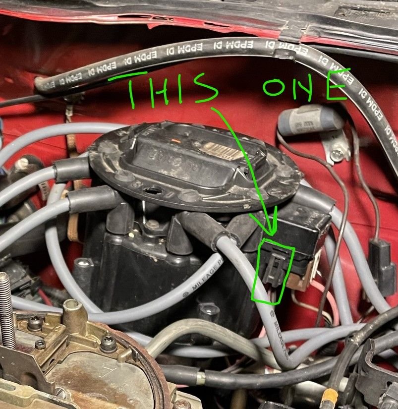

I did try to unplug "this one" here (in photo), but engine died. Wasn't sure what I was messing with.
Is EST same as the ECM? Wouldn't the same thing happen if I unplugged the 3 pin connector that runs to ECM (located on base of housing)? Would I have to jumper a connection for engine to run when ECM disconnected.
I'm interested in trying to set timing with EST/ECM disconnected, I just want to make sure I have say half an idea of what I'm doing.

No, don't disconnect that one. The EST/ECM wire is the 3-wire connector at the base of the distributor. Disconnect it with the ignition off, then start it. If the timing is way off, it may not run with that connector disconnected. You may have to move the distributor a bit to get it to start and run, then set it to the right position with the timing light and lock down the distributor bolt. Shut it off, plug the connector back in and start it up again. If you are setting the base timing to 8 degrees BTDC with the connector plugged in, the timing will be very retarded from where it should be.
I'll look into replacing O2 sensor, wouldn't hurt.
The one you unplugged is the connection for the ignition coil.
