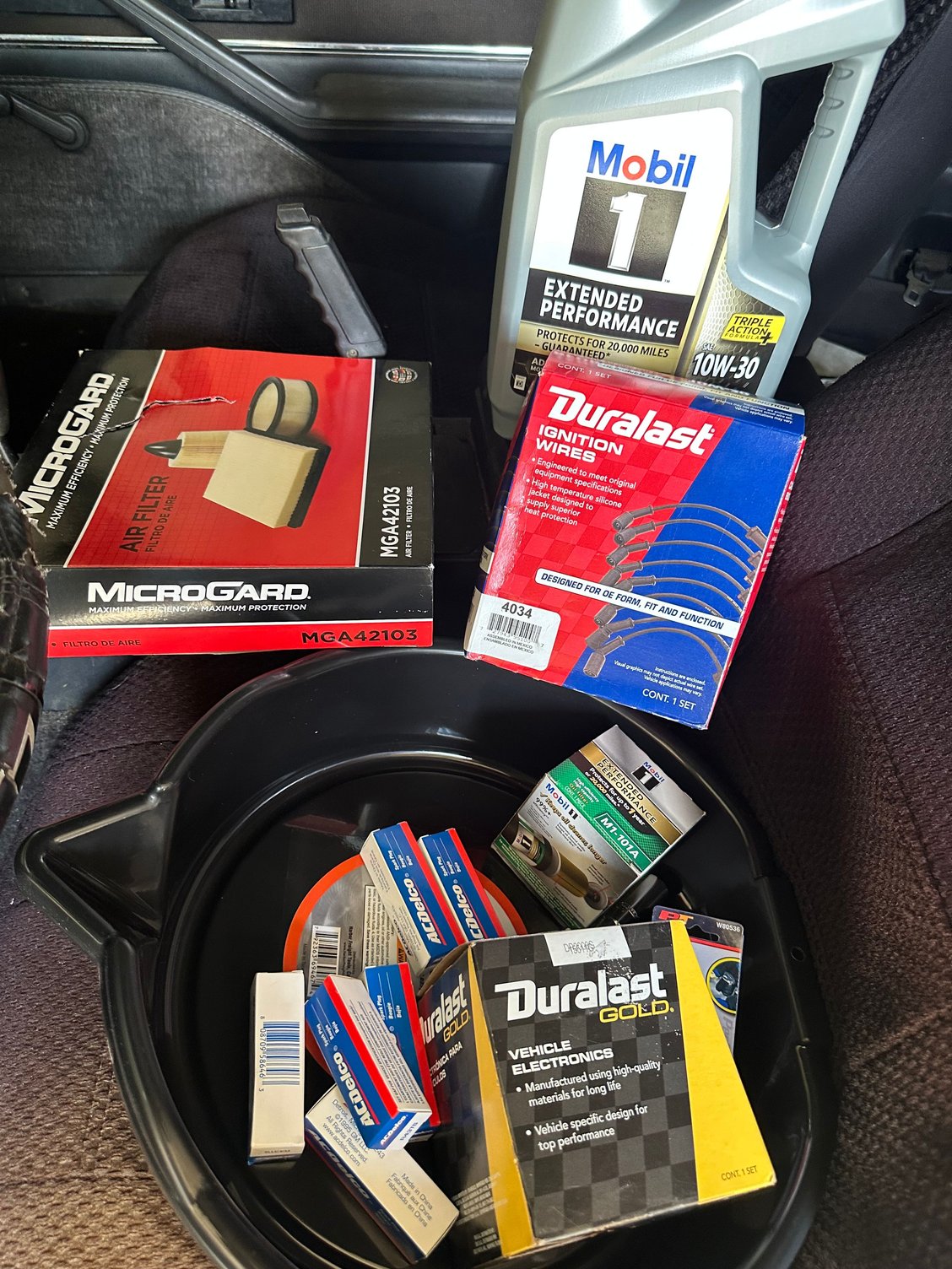

Hey what’s up everybody, got all the parts for a tune up. Gonna change the spark plugs, wires, cap and rotor and do an oil change. Haven’t gotten a chance to execute this yet, been so busy. I’ll keep everyone updated how this goes along, car needs a tune up anyway, the previous owner told me that as well so I figure why not and fingers crossed it resolves that “sputter”. Hope everyone is having a good Sunday.

*UPDATE* problem solved
changed the plugs, wires, cap and rotor and it fixed that sputtering issue. Took me all day didn’t change the oil yet but planning too. I thank everyone who posts for giving me the tools to trouble shoot problems, appreciate y’all so much! Y’all take care now!
