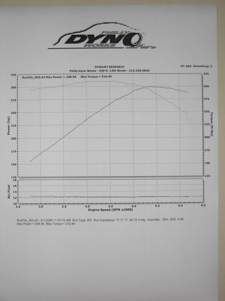

Through dyno testing, having an 8.75:1 1-ton TBI 350 Goodwrench crate engine, the 8,600+ GVW one thats part number ended in 20270 that is no longer made. Started out with 810 swirl ports. Then moved to 113 heads. Then moved to 906 Vortecs. Up to about 4,500 rpm the 113s and 810s had more torque than the 906 Vortecs, all 3 setups running a ZZ3/ZZ4 cam at the time. Those were the good Canadian OE Vortecs off the 350 in my 97 van that grenaded at 57K from hydraulic lock too. I had the heads gone through and they eventually went on that engine. The crappy Mexican 062s that came on the Goodwrench replacement engine in the 97 van made that engine a complete and total dog. Not even kidding when I say that engine was down 40 hp compared to the 57K mile OE engine that hydraulic locked from bad intake gaskets. The 906s flowed 242 @ 0.500, increasing throughout the lift curve to 0.530. The Mexican 062s peaked 218 @ 0.450 then fell to 210 @ 0.500. The Mexican heads cracked in less than 30K, at which point I put Etec170s on it. That engine had a mild cam and headers by that point. The Etec swap gained ~40 hp at the tires compared to the 062s. That was with the OE L31 truck manifold which I later replaced with a L31 marine manifold. I ported that L31 marine manifold and it currently resides on the 210cc aluminum heads on the 11:1 383 I replaced the 350 with. That engine makes ~550 ft/lbs @ 3,500 on E85. I would not put a penny in a Vortec head now. I used the last good set I had that were actually thicker deck aftermarket Vortecs on a L31 I recently built with a LT1 rotating assembly. I had already fitted those with LS6 springs and Comp 787 retainers 5 or so years ago. I recently shoved that L31 into a 1987 G20 van to replace a LQ4 with Lloyd Elliot ported 862s and about the smallest truck cam made. The 6.0L was more gutless than a stock TBI 350 with headers and tuning under 4,000 rpm. With a TH400 and 3.08 gears the LQ4 was always dropping to 2nd gear to climb even a small grade. The wimpy 6.0L could not push 4,500 lbs up a 6% grade at 2,500 rpm. The TBI 350 even with the stock cam in my heavier 1983 with a 700r4 and later on 4L60E had no problem making it up the same grade and held overdrive all but a steep 1/4 mile long section, where it would briefly pop down into 3rd. Then it would shift back into 4th and keep on going. 1983 had the same 3.08 gear and same size tires. My 97 at 7,000 lbs does not even unlock the converter going up that grade with the 383 chugging along at 2,200 rpm. 4L85E + 3.73 gear in the 97.

Quote: Through dyno testing, having an 8.75:1 1-ton TBI 350 Goodwrench crate engine, the 8,600+ GVW one thats part number ended in 20270 that is no longer made. Started out with 810 swirl ports. Then moved to 113 heads. Then moved to 906 Vortecs. Up to about 4,500 rpm the 113s and 810s had more torque than the 906 Vortecs, all 3 setups running a ZZ3/ZZ4 cam at the time. Those were the good Canadian OE Vortecs off the 350 in my 97 van that grenaded at 57K from hydraulic lock too. I had the heads gone through and they eventually went on that engine. The crappy Mexican 062s that came on the Goodwrench replacement engine in the 97 van made that engine a complete and total dog. Not even kidding when I say that engine was down 40 hp compared to the 57K mile OE engine that hydraulic locked from bad intake gaskets. The 906s flowed 242 @ 0.500, increasing throughout the lift curve to 0.530. The Mexican 062s peaked 218 @ 0.450 then fell to 210 @ 0.500. The Mexican heads cracked in less than 30K, at which point I put Etec170s on it. That engine had a mild cam and headers by that point. The Etec swap gained ~40 hp at the tires compared to the 062s. That was with the OE L31 truck manifold which I later replaced with a L31 marine manifold. I ported that L31 marine manifold and it currently resides on the 210cc aluminum heads on the 11:1 383 I replaced the 350 with. That engine makes ~550 ft/lbs @ 3,500 on E85. I would not put a penny in a Vortec head now. I used the last good set I had that were actually thicker deck aftermarket Vortecs on a L31 I recently built with a LT1 rotating assembly. I had already fitted those with LS6 springs and Comp 787 retainers 5 or so years ago. I recently shoved that L31 into a 1987 G20 van to replace a LQ4 with Lloyd Elliot ported 862s and about the smallest truck cam made. The 6.0L was more gutless than a stock TBI 350 with headers and tuning under 4,000 rpm. With a TH400 and 3.08 gears the LQ4 was always dropping to 2nd gear to climb even a small grade. The wimpy 6.0L could not push 4,500 lbs up a 6% grade at 2,500 rpm. The TBI 350 even with the stock cam in my heavier 1983 with a 700r4 and later on 4L60E had no problem making it up the same grade and held overdrive all but a steep 1/4 mile long section, where it would briefly pop down into 3rd. Then it would shift back into 4th and keep on going. 1983 had the same 3.08 gear and same size tires. My 97 at 7,000 lbs does not even unlock the converter going up that grade with the 383 chugging along at 2,200 rpm. 4L85E + 3.73 gear in the 97.
You should post those dyno graphs. Where are they?
If that is what actually happened, I'd suggest that the "more tq" from the 113's came from?....more compression. Change the piston for an apples comparison and I think you'd see different results. No way any stock swirl port made more anything, than any Vortec above 3.5k. By 4500?? Not happenin'.
