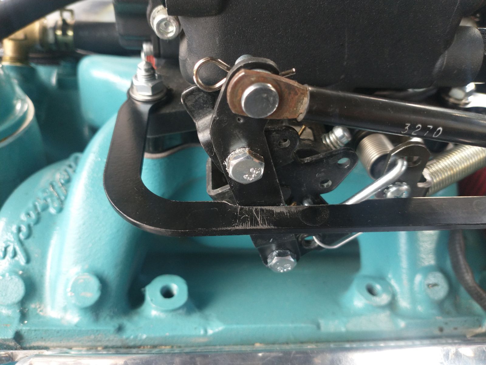

I used a Sniper extension lever and had to file the bracket a little. When I was done I hit it with a little trim black paint

Update:
Amazon Amazon
Worked like a charm once I got the cable length set correctly
