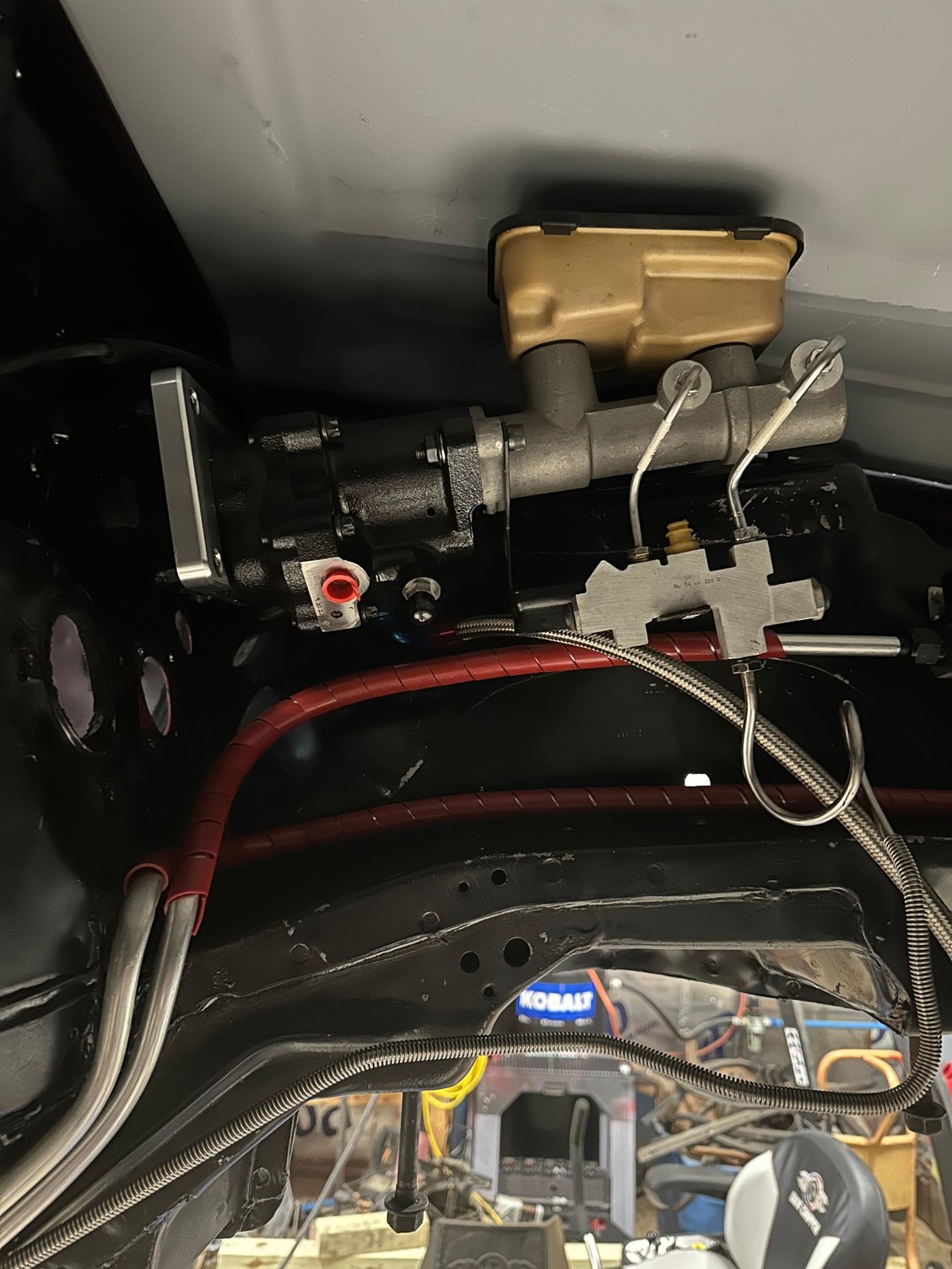

I'm not done with my 400 swap but..... I am using the OE metal lines on the left frame rail with the OE flex hoses into my fuel pressure regulator all on the frame rail fender area how ever it wants to rest and I'll screw it down to the fender. From there flex hose to front of engine where OE lines where and up to carb. My inlet is on the drivers side but the hose will go to the passenger side just as easy. Don't forget a filter at carb.

Wow, that is an impressive installation and one clean undercarriage! Looks like you 86ed the power brake booster like I'm doing. I've never been a fan of power brakes.

Yes sir, good luck. Just some ideas for you to chew on
This is a fuel injection set up but the carb is practically the same.

It looks like you only have two fuel system lines: did you decide not to use the charcoal canister?

Definitely not for me.
