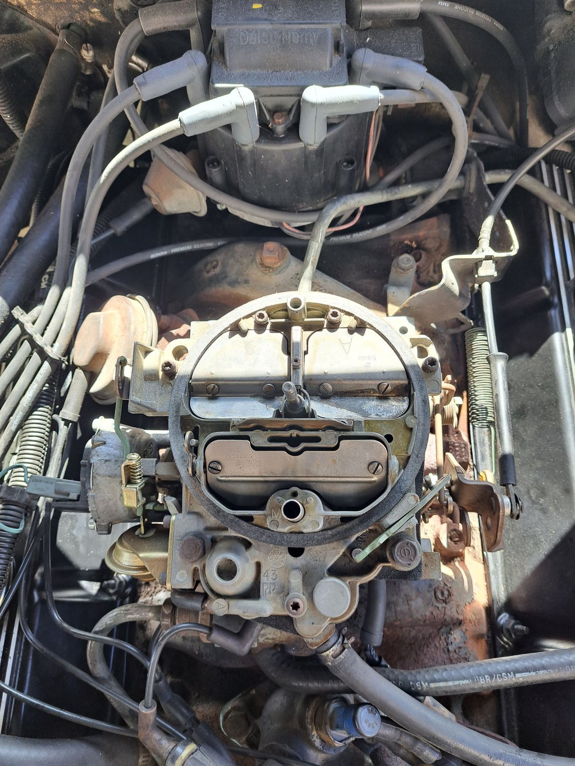

I have a 1985 camaro with a quadrajet 4bbl with electric choke. I have a rough idle foud a leak betewn the carb end intake. Now it fix it idle fine but idle arond 1500rpm when hot when it cold in sputed and smoke and smell gas, i have to rev it arond 2500 for 30 sec then it ok. My idle srew is back out all the way. Can a rich or lean mixture cause it? Maby a vacum leek? I dont know of any more adjustment. Dont know what to do.

Look at the place where the throttle cable hooks up. (right side of the photo, right in front of the big spring) Look right below that in the photo. (large cylindrical object with a wire going to it)
That solenoid. That wire. Unplug it and see what happens to the idle speed.

This is what mine look like. And thank you for your help im 20 years old been a mecanic for 3 years sadly they dont teach about carburator in school!
