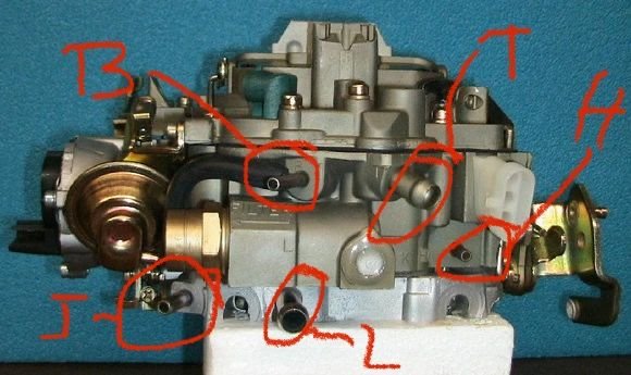

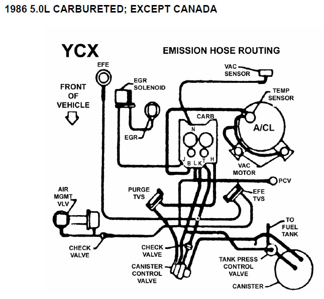

Hey guys searching for this I came up empty so I thought I’d ask. Are my labels correct on the pic? If so where is K? I see the letter on the carb but no port. It’s also on my emission routing sticker so there’s gotta be something I’m missing.

Not all carbs have the "K" port, in which case you must tie into the "L" port with a tee-fitting...

thank you! I knew it must’ve been something not shown. That’s weird that they put it on the sticker anyway.
