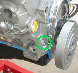

The fuel pump has a much smaller flange and bolts on with only the 2 larger upper holes. Replace both gaskets, plate to block and pump to plate, obviously.
Note in that pic that there's a bolt hole circled. MAKE SURE there's a SHORT bolt in that hole, if the bracket isn't there anymore. If you look into that hole you can see the FP drive rod, and if there's no bolt there, it will leeeeeeek oil SHAMELESSLY at high (pretty much anything above idle) RPMs, which will then get slung by the crank damper and coat the ENTIRE pass side of the engine down low, and the underside of the exhaust, with oil. If you have that going on, put a SHORT (like, ¾" or shorter) bolt in there with a drop of sealer on the threads.
