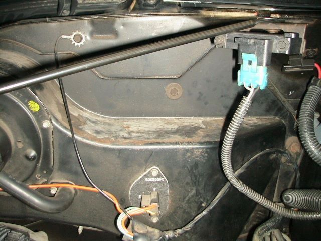

Picture below show where it mounts. It goes under the protruding lip on the cowl where the pencil brace mounts.

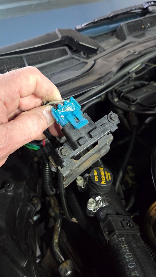

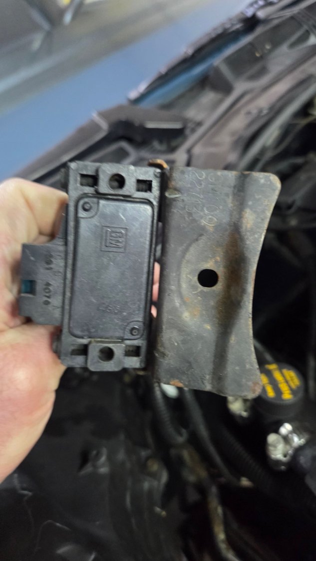

Thanks guys! Any photos of where I need to mount it?

Mounts Here

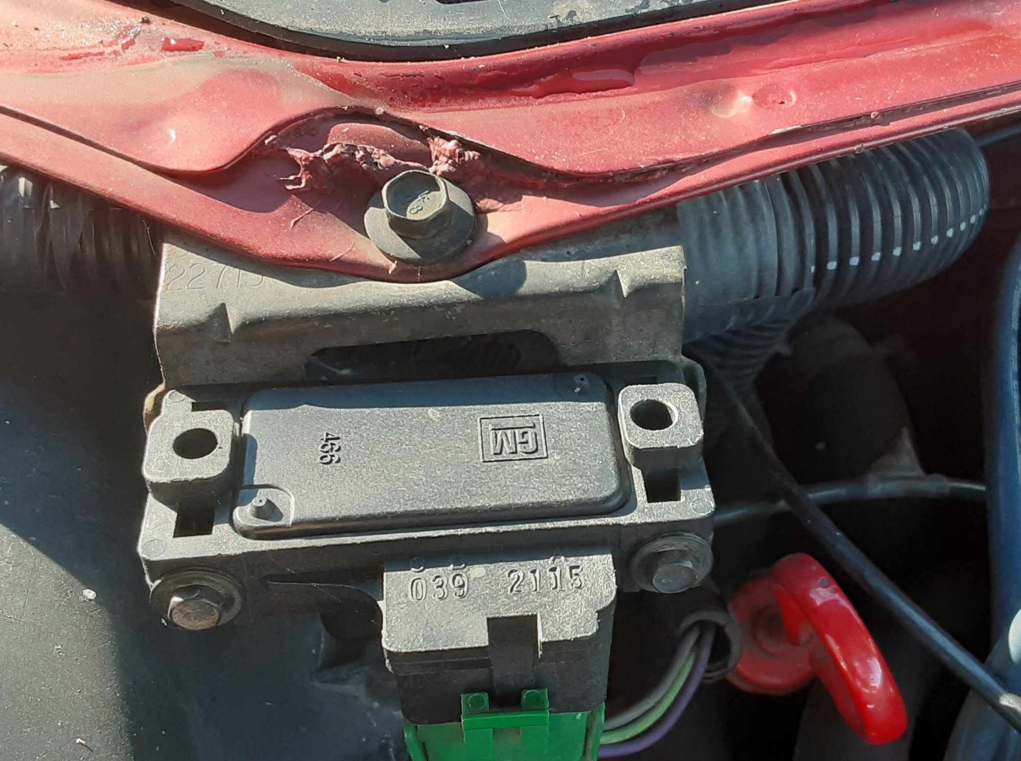

The MAP sensor is on the driver's side firewall between the brake booster and driver's side fender. It's keyed differently and uses a different color harness connector. I think MAP is green and BARO is blue. It's a 1 BAR BARO sensor and a 1 BAR MAP sensor.
