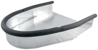

A found a couple of options for a decent carb seal.
The All Star pan I think is intended for the oval track crowd and a hood that doesn't have a sheet metal frame and the circular opening that my hood has.
The Ram Air part looks pretty good. It's made up of several components though and requires an seperate pan that has the needed drop so the gasket seals correctly.
If I could find the foam/rubber seal, I'd build this part myself. I have plenty of air filter cases kicking around.
You don't need a dropped base and I would not recommend it since you now have plenty of room now. I've seen basic lower carb pans that are designed for scoops either forward or cowl style. They are square and you trim the upper lip to fit close to the hood and then you put the rubber trim molding on the lip to seal it to the underside of the hood.
These guys make about anything you would need for molding--> http://www.trimlok.com/
Years back I had a L-88 cowl hood on my 72 and I didn't seal the base up to the hood but with a 3" filter it stuck up into the cowl and it did lower the intake air temps over the stock air cleaner which was open to the engine compartment, no cool air snorkel like the 3rd gens have. Sealing it is a better option if you have the time and ability to do it. I didn't have the car long enough to seal mine up.

Yep, that hole is centered on the hood, but our engines are not centered.
The Jongbloed hood is made to seal and it does right.
You can get Foam from Moroso to seal.
I checked out Moroso. I didn't know they made half of what's on-line but I didn't see any foam seal. They show it as a part included in their air pan kits, bit no individual listing. The 1 1/2" x 4" x 60" piece would be ideal if I could get it seperately.
Edit: Found it. Looks like I'll build my own air pan kit.

My previous searches yielded the following pictures. There appear to be obvious differences however I've never seen either hood in person. It's difficult to tell as the photos aren't from the same perspective.
As for the offset, Johnny Blaze reports that the offset is built into his. I can't comment on the Sunoco branded version.
Edit. From the post preceeding this, it sounds like they're one in the same.
Jongbloed is listed on Spohn's website. The Sunoco hood is listed at Hawk's.

Re: Cowl hoods and carb sealing
Yep, and both are probably getting them from the same source.
