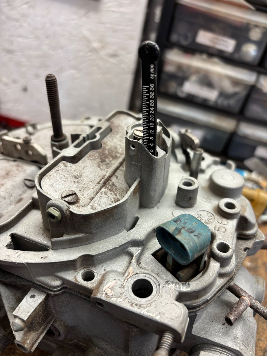

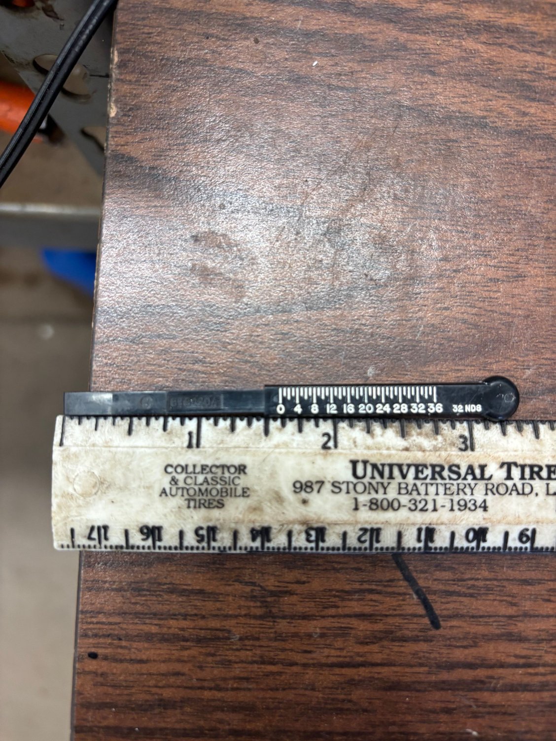

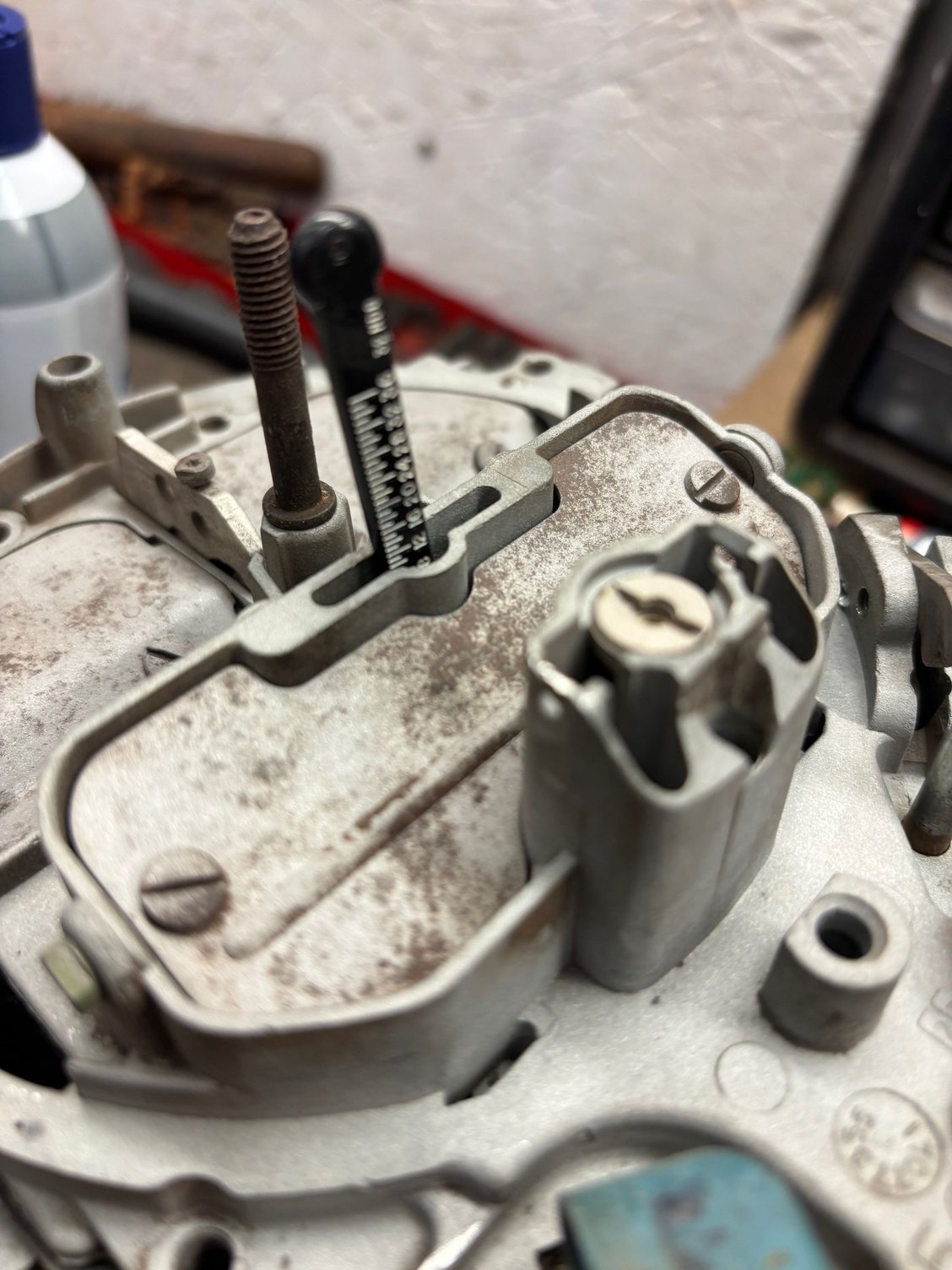

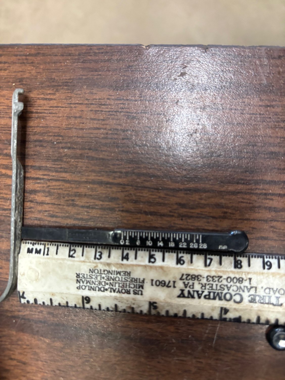

OK that all sounds good. Take a look at the attached photos and you will see a GM gauge used to measure the float height and the mixture control travel externally, sort of a dipstick to check them. With these measurements you can make your own gauge, note that the gauge lines start 1" 5/8" from the bottom of the stick. Your float height measured at the center hole with the engine idling is supposed to be 11/32. Having set the lean mixture screw while rebuilding the carb you now set the rich screw (engine off) for 4/32 travel (some say use 5/32). Hope this helps, good luck

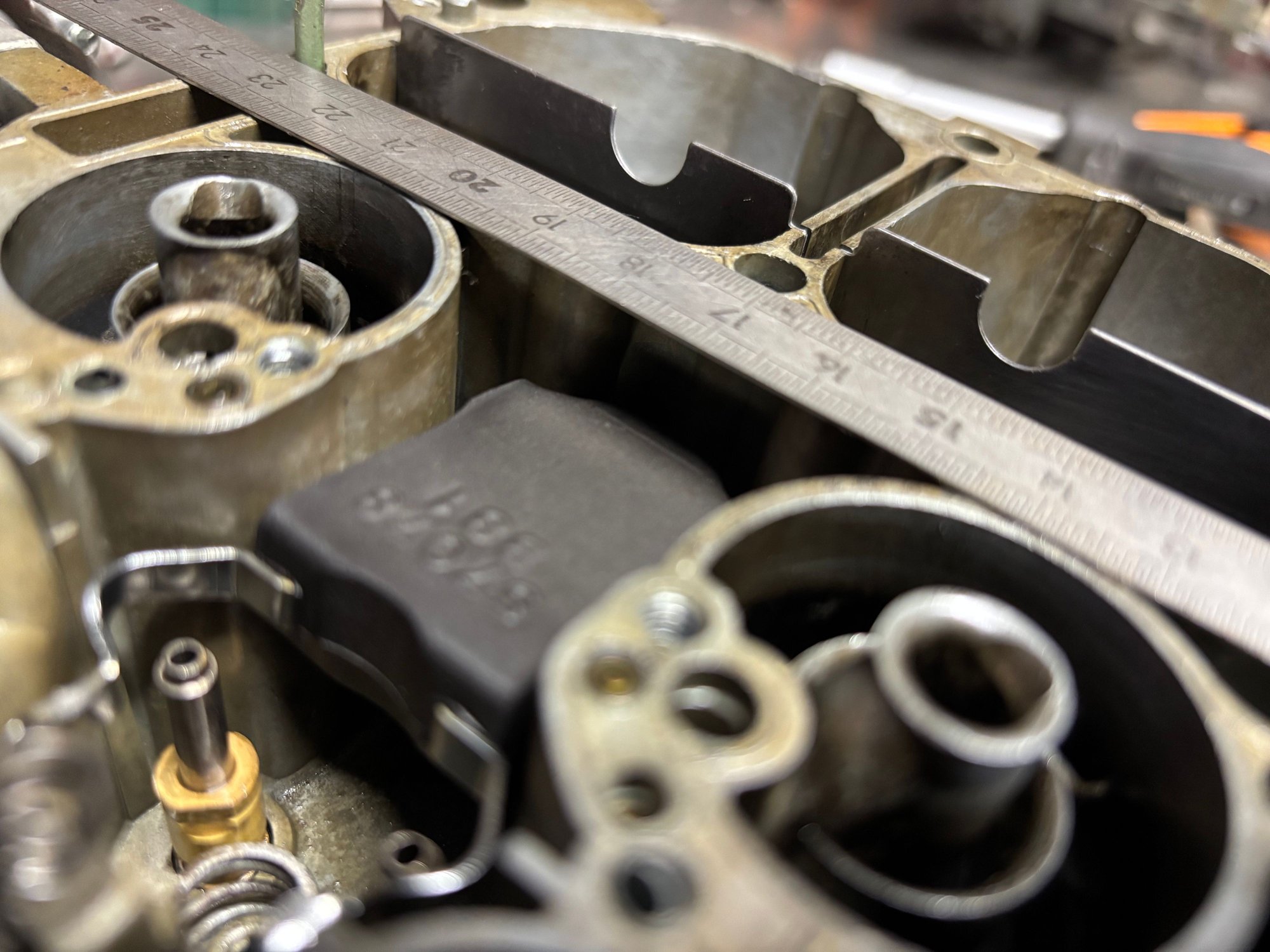

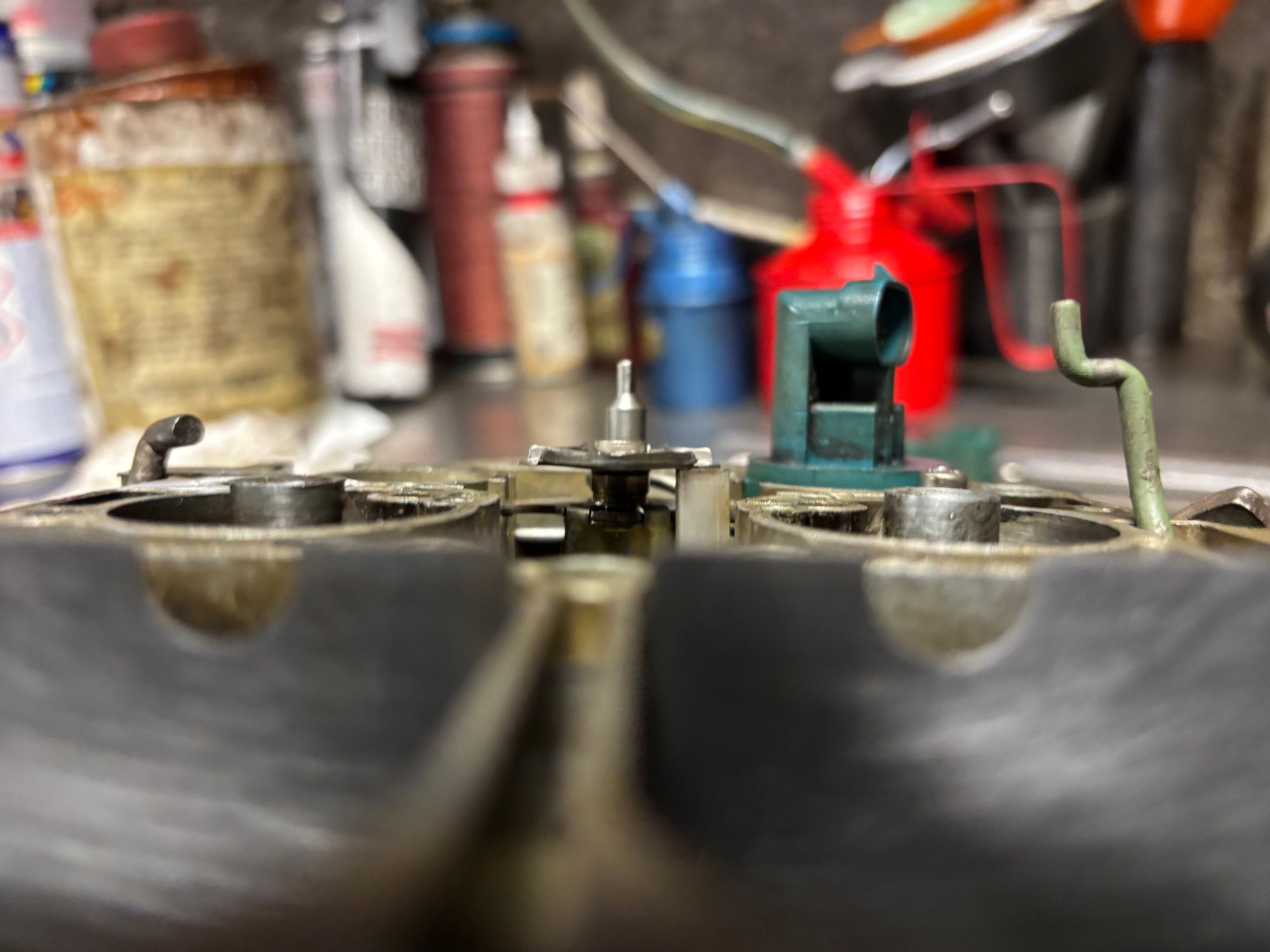

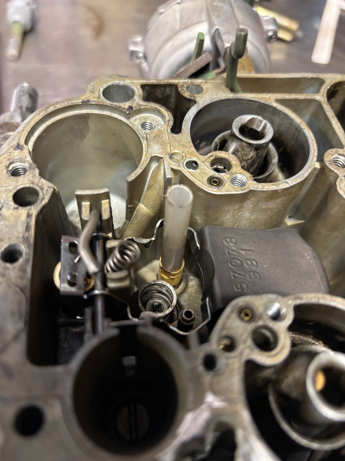

I dissassembled the carburator, in the end, I missed a lot of settings.
First, the float level is too low :
Secondly, my gauge wasn't exactly 1.304" ; I made a new one why a inch ruler
Unfortunately, when I removed the rich mixture screw plug, I stripped the threads
Unfortunately (yes again) , I broke thread tap inside...
