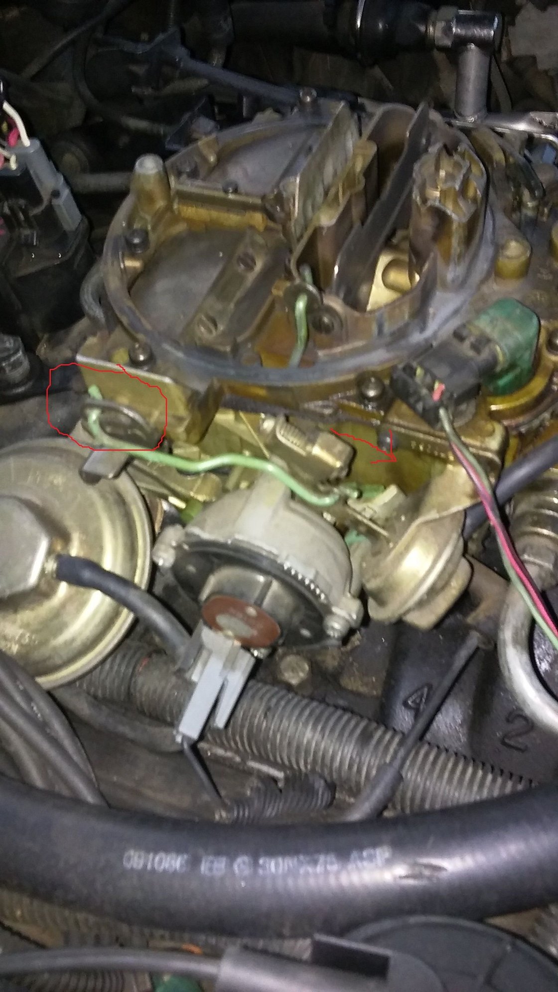

so i just went out and tested the choke pull off. It works. stays pulled in when vacuum is applied however it doesnt seem to do anything to the choke plate and when the green rod thing pulls on the thing connected to the rear choke plate it does absolutely nothing it just goes back and forth freely without opening any plates. front plate seems to always be fully open even before a cold start. also i dont think my secondary choke plate ever opens at all. I ran the car at idle without tps plugged in and had a nice even idle. I plugged the tps back in and the idle went to ****. It was a little rought and kinda surging but not the kind of "car shutting off surging" that im talking about while driving.

I also think i broke this a while back while messing with the air filter cover. It is connected to a vacuum which connects in a T connection with the choke pull off before going to the front of the carb. might this be affecting it as well? and if so what is this?

The green link thing that goes to the secondaries:
Does nothing whatsoever most of the time. Butt, since the vacuum diaphragm is pulled in under most normal circumstances, when there's high vacuum, it's all the way toward the front almost all the time. BUTTT: when vacuum disappears, such as when the driver floors the gas, a calibrated orifice in the diaphragm allows it to retract rearwards at a controlled rate. Notice that when it's forward, the secondary air valve CANNOT open, i.e. CANNOT let in air, i.e. PREVENTS the carb from leaning out and giving you Quadrabog. It is therefore a control mechanism to prevent that. Quaadrabog is caused almost exclusively by the secondary AV opening when it shouldn't; either too fast when it should be slow, or at too low airflow for the engine to be actually needing it at the moment. Yerbasic lop-eared knuckle-dragger's "improvement" consisting of loosening the AV, only MAGNIFIES it. There's only a handful of us left that know how to tune a Quadrajet... learn from us how it REALLY works and ignore the Friday night In-N-Out parking lot monkey-spank.
The thing in the air cleaner is a temp switch that operates the "Thermac" valve in the snorkel, such that when cold, the valve is closed and the engine gets its air from the heater stove thing around the exh manifold so that it suffers less from general coldness. When it warms up it opens the valve and the engine gets air the normal way. I'd suggest getting a non-broke one at the buzzard nest.
Iunno what part of LA you're in; but when I lived in Carlsbad, I used to use a Pick-and-Pull type place in Oceanside, right off the 78, across from the Oceanside airport. I'd suggest going to there or some similar place and getting one of those "Thermac" switch things out of some car. The same part was in all sorts of cars & trucks so shouldn't be too hard to come up with something that will restore it.
