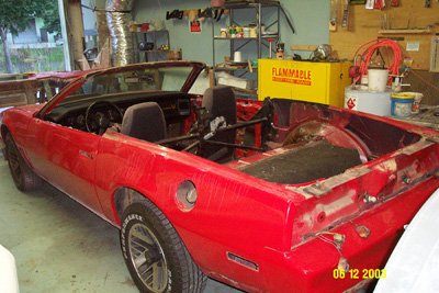

Is it possible to convert a hardtop/T-top into a fully-functional convertible?

Sure every convertible here went through it, via ACS.

that's what I heard, actually the site I got the pic from said the transformation was done kinda hald-assed, with bondo & the whole 9yards....

check it out

if you look close enough you can see the rearseat mount, on the other pic

you misunderstood, the pics are of a restoration of an 82

so what you're saying is if I found a junked conv, ALL of the convertible stuff would fit to my car if I cut the roof off.....?

Bingo! But you'll need to be a little bit more creative then that. You'll need to cut out all the welded convertible pieces and re-weld them into the project car. Having major fabrication tools and skills would go a long way in doing this. For the most part though it's usually easier and cheaper to buy a vert and make it what you want it to be.

If you have fab skills it can be done... Mine is looking better then the factory job.
Im also mini tubbing it while Im at it.
T-Tops
TARGA Top..
I was gona keep it as a Traga and finish a carbonfiber top I was doing. but a buddy jay plans to do it also.....
http://www.cecoatings.com/images/Car...gatop/low1.jpg
and now off to a Fully Funcitonal vert like if the factory did it.
Tono open some so you can see the where the Mini Tubbs will be and still keep the back seats. This will let me stuff a 315 under the lip no problem.
