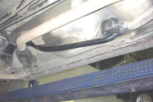

Alston's installed
Attached Thumbnails sub frame connector help-c-documents-settings-les

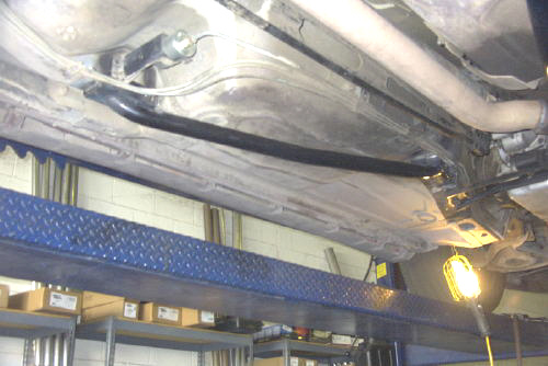

and the other side

those work good for ya? make a noticable difference?

absolutely
place a jack under the jack point in the front and lift and the entire side of the car comes off the ground....can open and shut the door with it up with a LITTLE difficulty....not really recommended but it can be done

just to clear a little confusion...
Those pics are not of my convertible. I found these on this site 6 or 8 months ago to use as an example for the installer that put mine in.
Mine are welded and bolted.... Underside of my car not near that clean.
Yes with the side jacked up, I can with difficulty open the door. Towards the front of the car @ 6 to 8 inches behind the front wheel well, is a jock point...little indentation in the framework. Place my floor jack there and lift the entire side of the car....enuf that i can put jackstands under it both front and rear.
