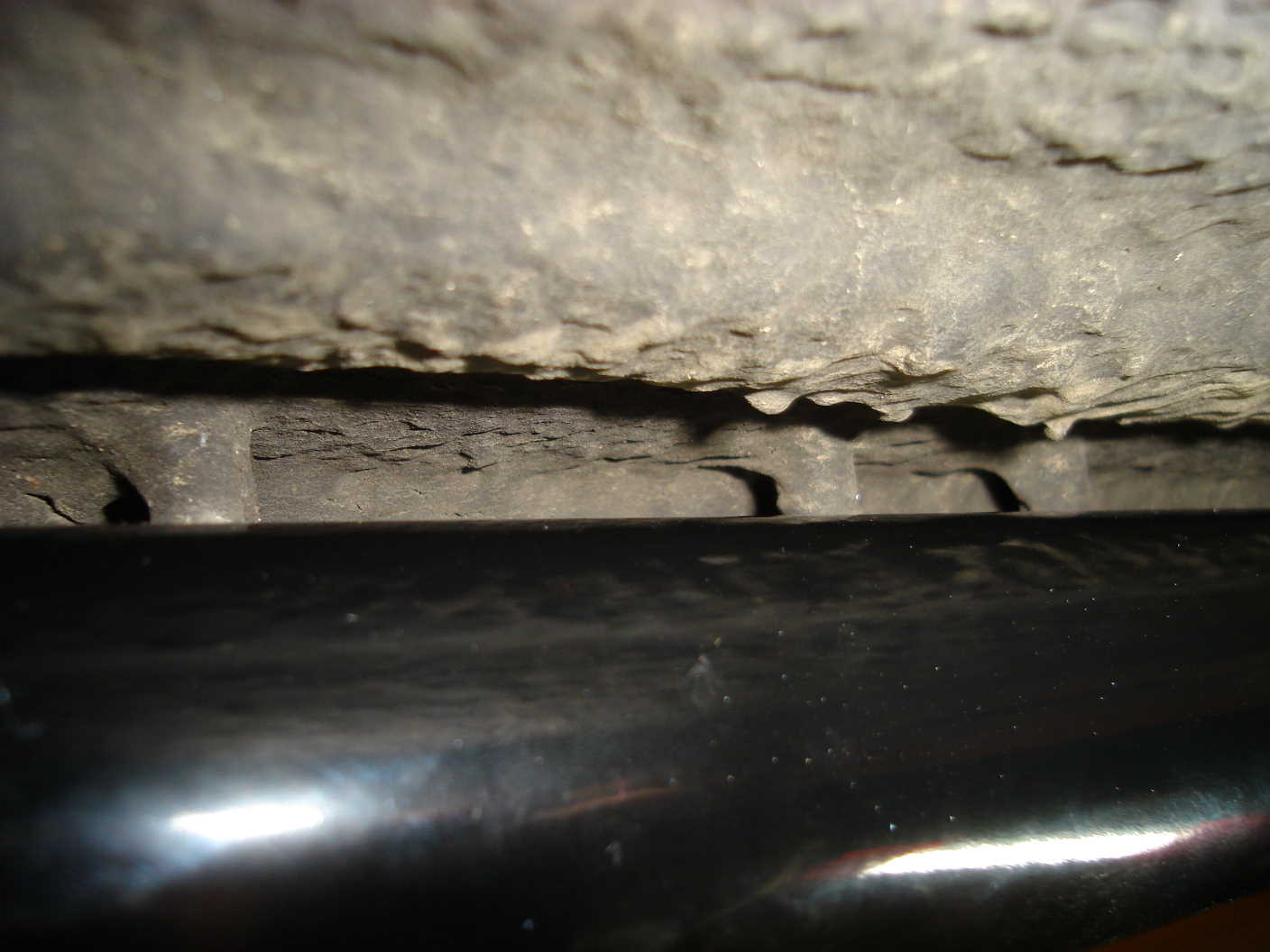

Cra-z-canuck,
Do you think you are going to have the same problem installing the Spohn SFc's that I had? My post was called "aborted spohn SFC install" I think. I posted it in the convertible and the chasis forums. The post was about 4 weeks ago.
One of the problems is the ASC installed rivets that hold the brace in.

I'm assuming that the problem was that you or your shop was putting them on without loading the suspension (ie. a drive-on ramp). I'm hoping that was the problem anyway! I have a great shop that is going to do the work.
Old Mar 20, 2006 | 08:30 PM
plndtx's Avatar
Joined: Dec 2005
Posts: 428
From: Friendswood/Pearland
Car: '92 Heritage Z28 Convertible
Not having the suspension loaded was one of the problems. The other was the rivets that ASC used to attach their supports, hung down about 3/8 inch from the floor pan. It is going to be hard to weld the SFC to the floor pan with the rivets in the way.
