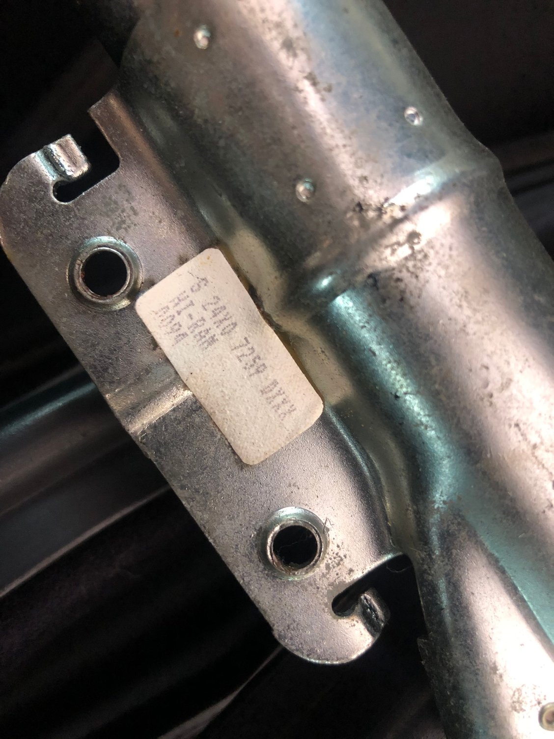

Is this the switch? I couldn’t find any info regarding it, thought it was part of the alarm system...now to rip trunk apart again too....

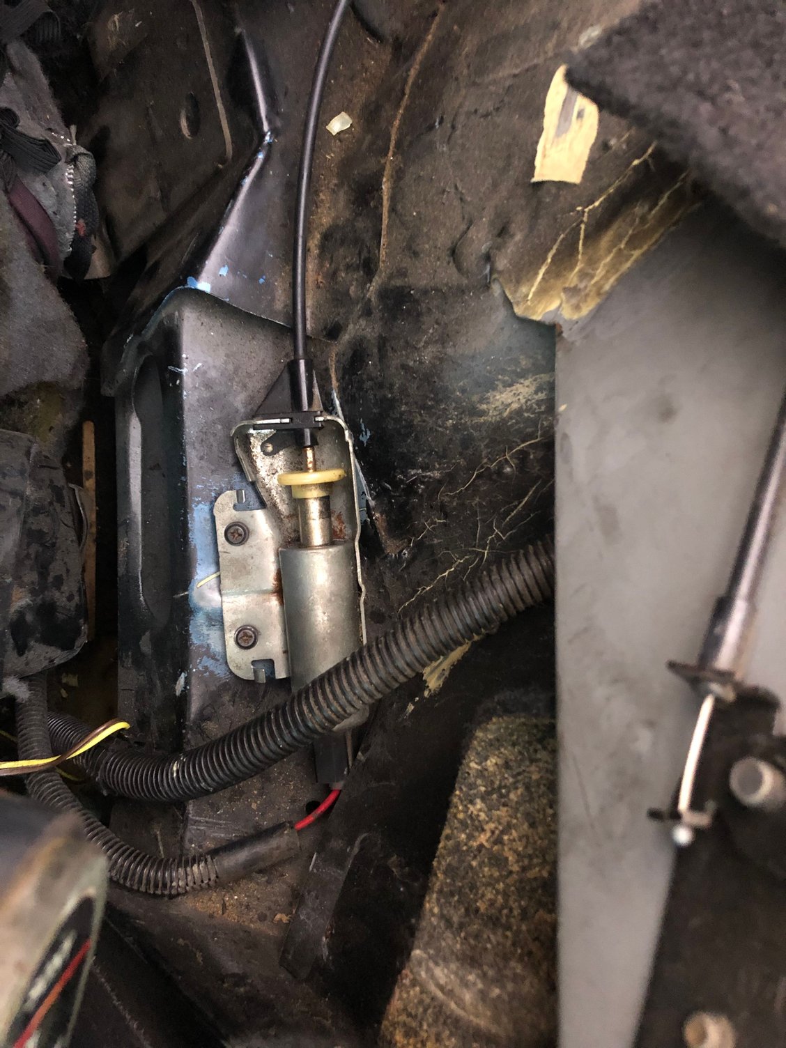

Ok position switch mounted, no joy on solenoid operation...BUT I stuck the switch in on position to check some wires and noticed this...trunk light has power...now that being said...been wondering why trunk lights is spliced off right side solenoid power...but it does make me feel better that there is a signal getting through relay and switch out to the car.
Yes that is the plunger switch.Your solenoids will not fire unless that is connected.

Got power to the solenoids…12.8 each side…still cleaned the mounting area…no joy…if I trigger switch and push the plunger in it will “stick” in the pulled position so there is power to and in the solenoid…not strong enough to pull it though. Bad solenoids? Also is this correct mounting? Seems hokey to me. Anyone have a good part number as RockAuto doesn’t seem to have anything related to tonneau.

I sprayed mine with a healthy dose of WD40 ansd worked the plunger in and out. Freed them up nicely.

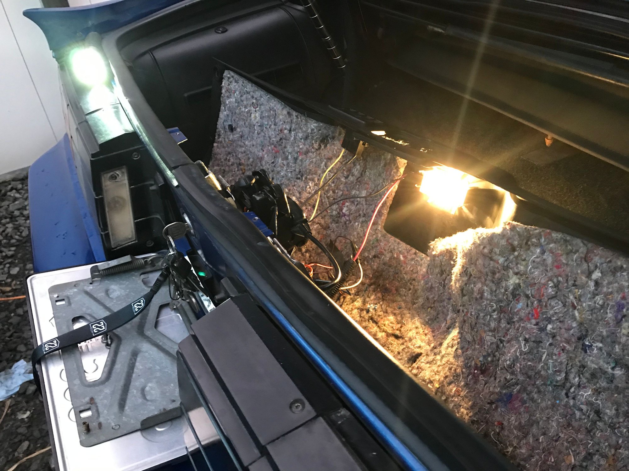

I was replacing my latch pull and found some spliced wires. I was wondering if anyone knows how they are supposed to go. I'm now trying to get my tonneau release to work and think that might be the problem. They are the blue and white wires.

Sorry, I don't know the answer, but screw on wire nuts, used in a vehicle, is totally incorrect.

Yeah it seems the previous owner Jerry rigged most of the wiring on this car. Those are some type of plugs, not wire nuts. Thanks though!
Hopefully I can clear a few things up as I just went through this with my 89 Iroc Convertible. I circled a few connectors, which are factory below:
The blue wire circled in yellow will provide power to the pull down relay which should be next to your pull down assembly. This should connect to a +12V source all the time. In my case this was a red/wht striped wire. The white wire circled in red provides power to your cargo lamp and should be connected to an orn/blk wire on your cargo lamp. This has a split from the factory as it goes to the relay and closed switch as well as the cargo lamp on the plug. This should provide power to light when your pull down is in the 'up' position. Circled in green will be your tonneau release switch. This switch should be closed when the pull down is fully closed which will provide a connection between a black wire, which is a switched +12V source from the center console switch.
For the tonneau release to work you need to meet a few requirements. The trunk must be closed completing the switch in the trunk, this is what's circled in green in the picture above. The red wire will run to the passenger side release solenoid and split over to the driver side in the main cabin under the carpet. In my case being a manual transmission, my parking brake must be set to ground the coil for the relay in the center console to supply power to the switch in the center console. I would recommend initially checking for power at the black wire circled in green while pressing your center console switch. If this is good then you have a bad switch on your trunk. This could technically be omitted as it was a failsafe to prevent opening of the tonneau while the trunk was open. If this is not good you must troubleshoot the power coming from your center console.
The pull down connectors in your picture do look correct. I also thought the factory wiring looked questionable. I hope this helps, let me know if you need clarification.
