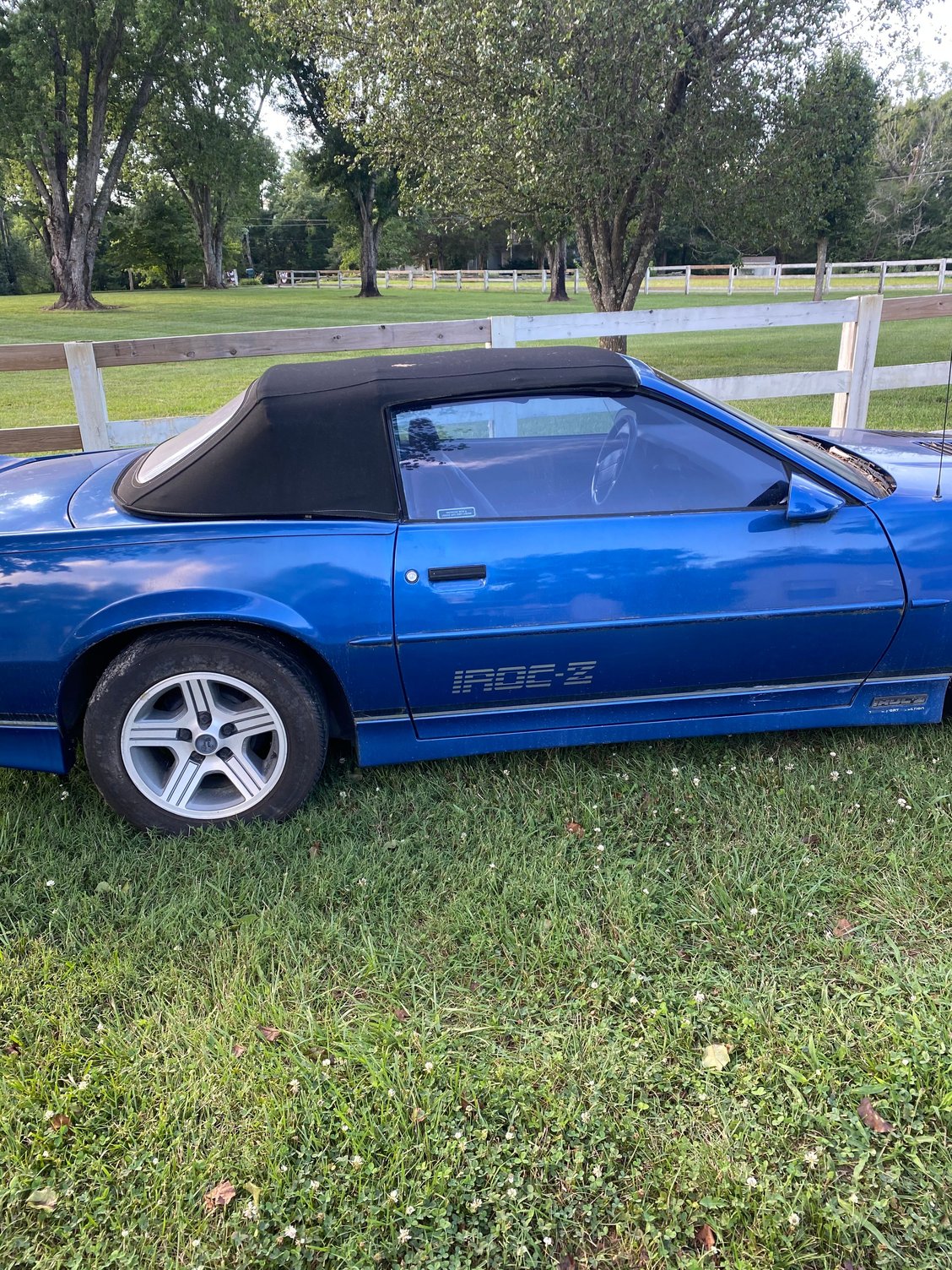

Posts: 25
From: Ringgold Ga
Engine: 305 tpi fuel injected
Re: Does your vert Trunk / deck lid struts / supports / lift enough to clear pulldo
I just bought a 89 convertible and need to replace the ones on the trunk and hood.

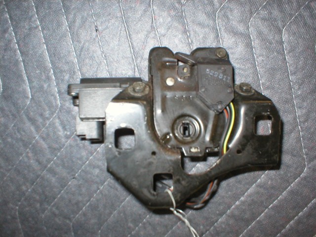

My 89 is the same way, new struts did nothing for it and in fact, I think it's worse.
Could get lucky and find a late 92 trunk latch. Not sure if it works with the metal support the pull down style uses though.
Old Aug 17, 2020 | 10:31 AM
okfoz's Avatar
Posts: 14,298
Likes: 197
Engine: 5.1L TPI, 5.0L TPI
Transmission: 700R4, M5
Tony,
The latch attachment is completely different for the late 91-92 than the earlier 86-91 style. So you would have to do some magic to get it to work correctly.
John
