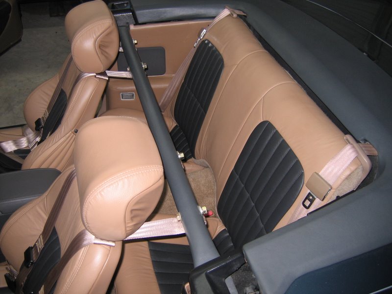

Here is where I put mine , gets the trunk back (the little that there is) and they are removable so the rear seat pads can go back in
Attached Thumbnails Convertible Subwoofer Advise Needed-photo0118.jpg   Convertible Subwoofer Advise Needed-photo0124.jpg   Convertible Subwoofer Advise Needed-photo0125.jpg
