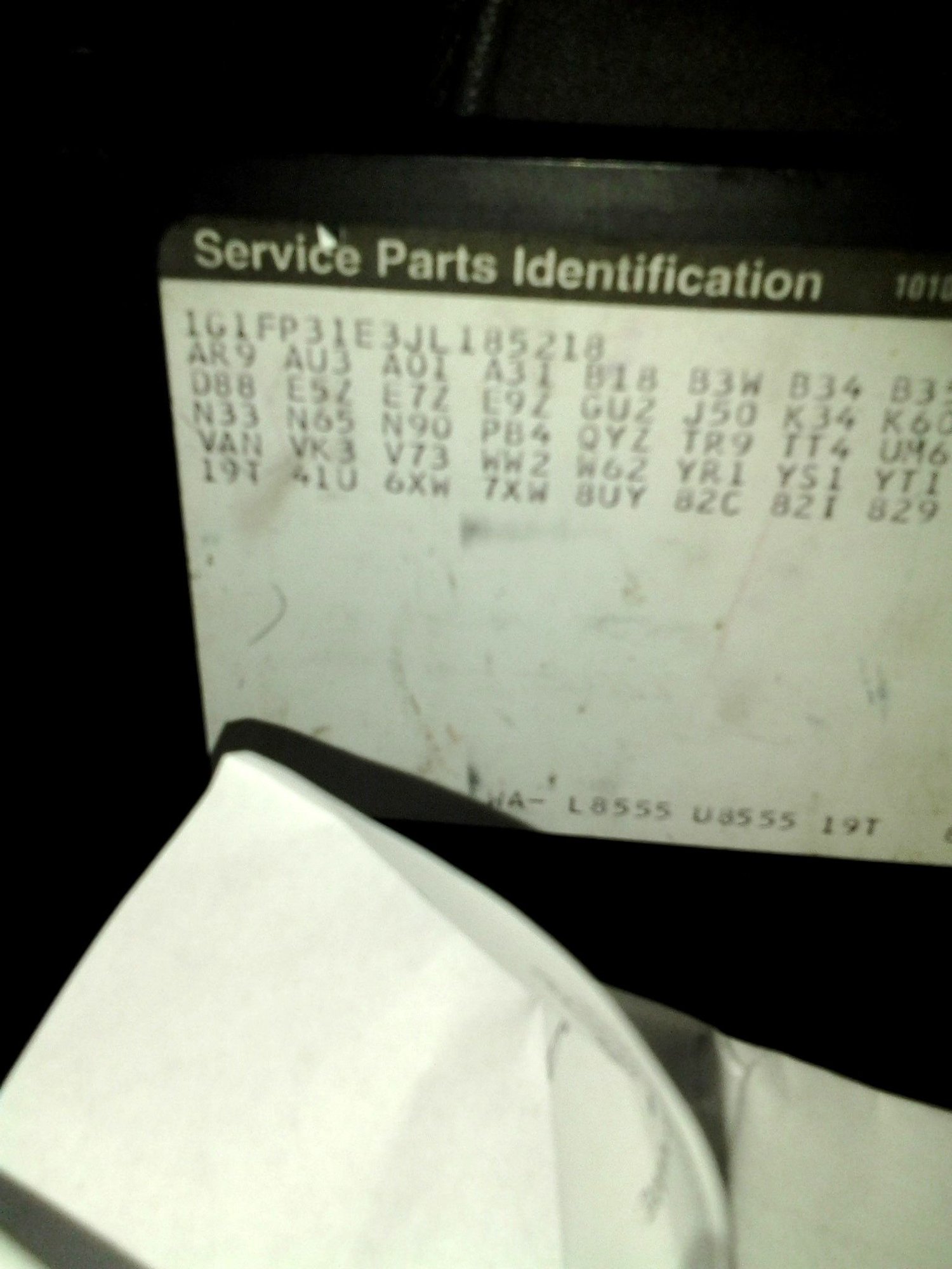

Looking for some good advice and I know I will find it here. I recently purchased a 1988 Convertible, and when my Car dealer friend ran the CarFax for me it came up as an IROC. The problem is, there are no door decals and the badging on the car only says Camaro... is this really an IROC?

If your RPO code sticker matches your vin, then post a pick of it and we can decode it.

RPO Sticker
Find RPO sticker in back glove box or console, look for ....
Z28 : Special Performance package

I am having a problem posting the pics, but I didn't see Z28 anywhere on the sticker.....

It's most likely not an IROC. Would be a lot easier to help you if you could post up a pic of the RPO Codes.

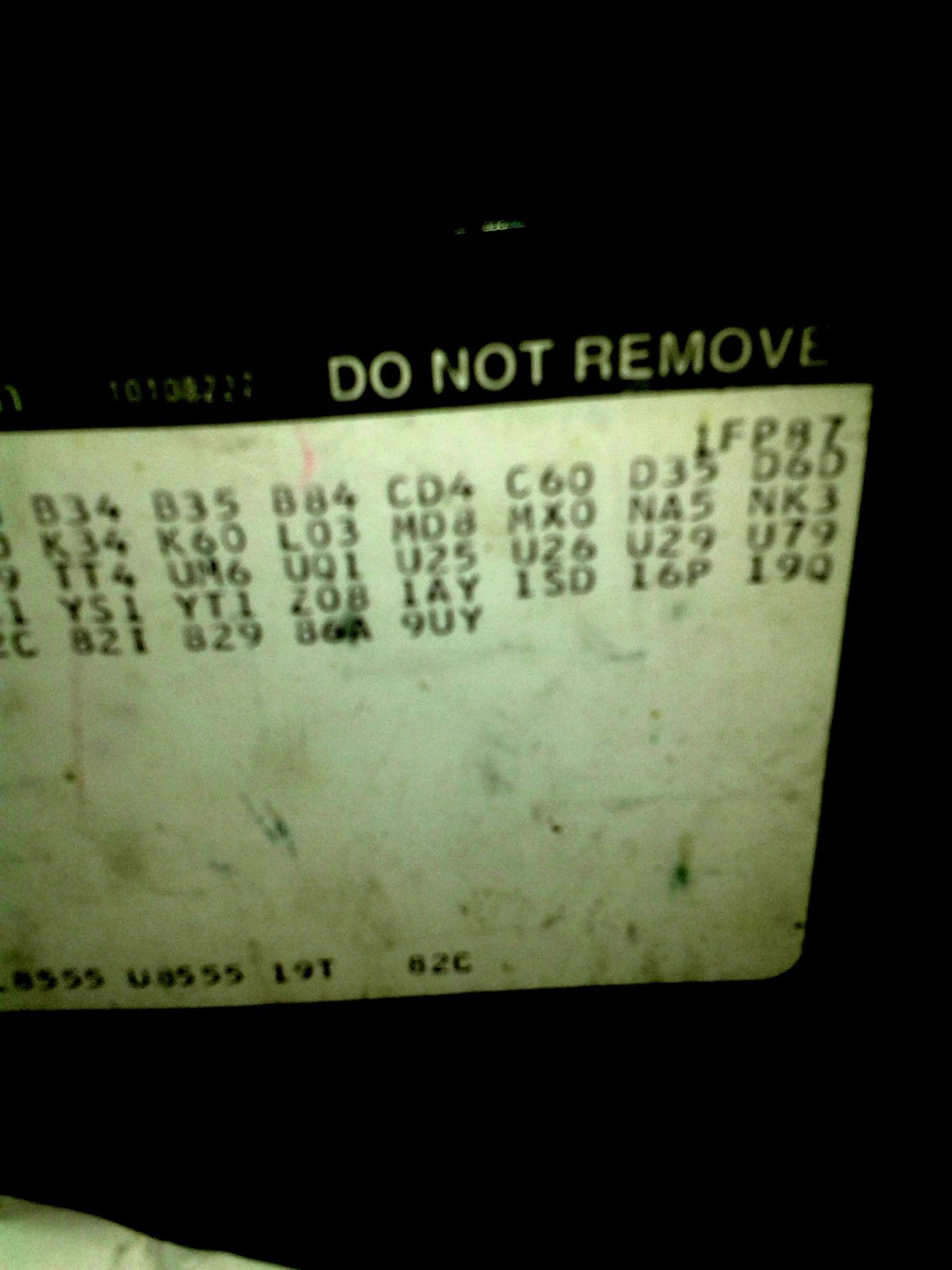

Here are the pics... I had to take 2 to cover the entire sticker.

Your SPID confirms what others have said...your camaro is not an Iroc.

Thanks for the info... was there possibly some kind of mistake made when the original title was released that called it an IROC?

Sounds like it just has the Iroc look and not the bones.
WW2 : APPEARANCE PACKAGE(SILVER), AERO #2
W62 : ORNAMENTATION, AERO PACKAGE
B84 : ORNAMENTATION, EXTR MLDG, BODY SIDE
1SD : OPTION PACKAGE 04
A 1SC is package 3, which is Iroc according to this window sticker ...
