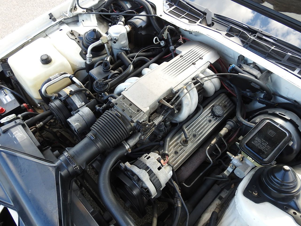

New guy here. I'm looking at a 1989 iroc convert. Is there anyway this could have gotten a 350 from ASC? It shows a #3 and a F in the vin but seller says it is a 350 matching numbers.

The "F" tells you the car began as a 305 CID, not a 350. ASC did not do any engine swaps. It could have been swapped by a previous owner which would negate the "numbers matching" claim being made.

Is there any physical differences by just looking at a 305 vs 350 , like plumbing wiring?

The only thing you can do is to look at casting numbers on the block.
And calling ASC would not have helped - but we're here to try
Believe 1987 and newer blocks say 5.0LG or 5.7LG. LG stands for Liter Gas
In the meantime, should find one of these:
14088526 Small Block V8 1987-1989 350, roller cam, 1-piece rear seal
14093627 Small Block V8 1987-1991 305, 2 bolt, roller cam, 1-piece rear seal
14102058 Small Block V8 1987-1991 305, 2 bolt, roller cam, 1-piece rear seal

First and Foremost, if it is an "F" then it is (was) an LB9 from the factory. Don't believe the smoke people blow. I don't believe it would even have the G92 axle in 1989 if memory serves. Is it a 5 speed too?

So I emailed these guys for a photo of the RPO sticker. It looks clean but for a few things. Steering wheel needs a rewrap and some goofy wiring going on under dash.http://www.gatewayclassiccars.com/mi...maro-S340.html comments/advise?
