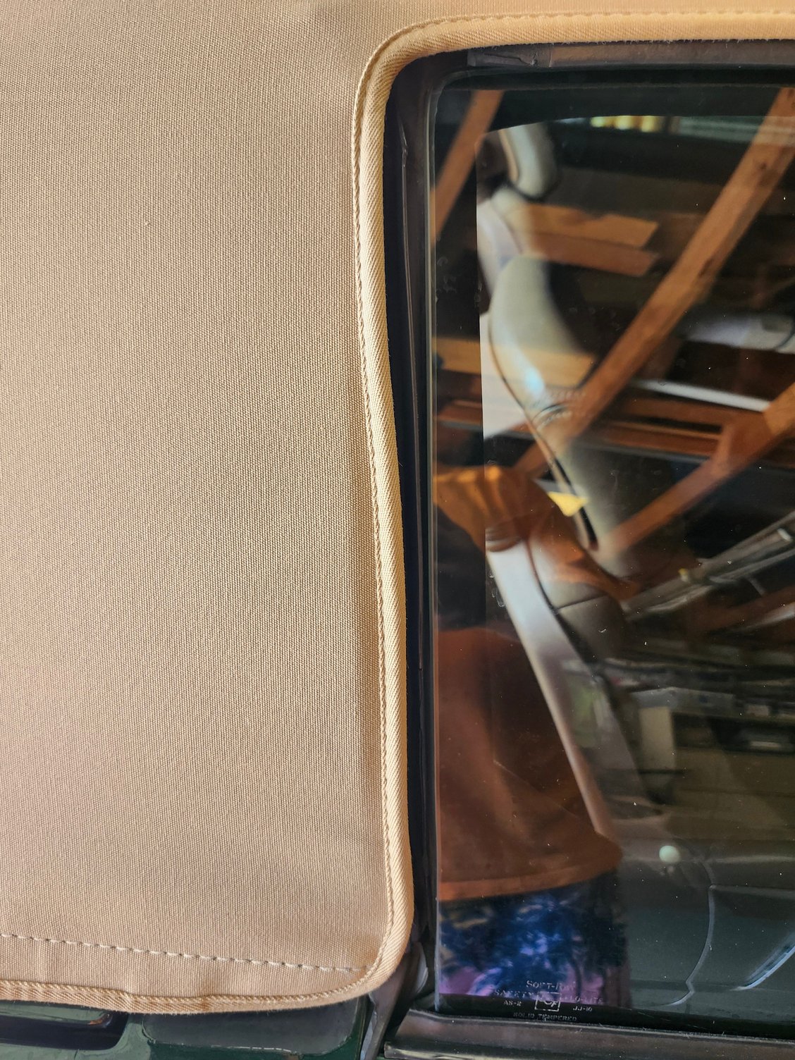

I cannot see a lot fron that one picture from the rear, because I can't see the seal, but your car looks nothing like mine.....and I can use high pressure water and it doesn't leak....

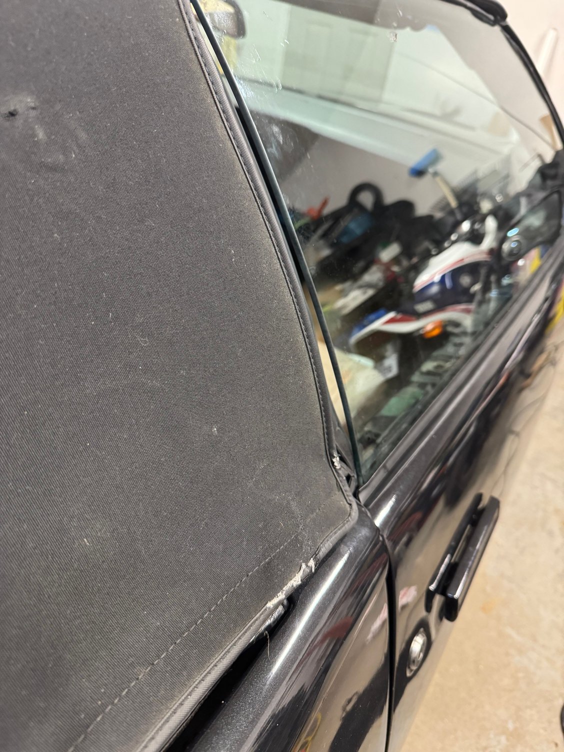

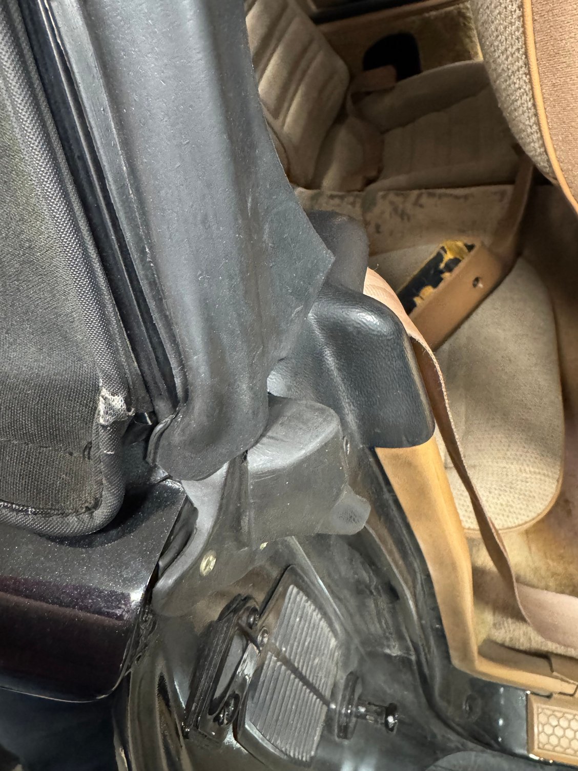

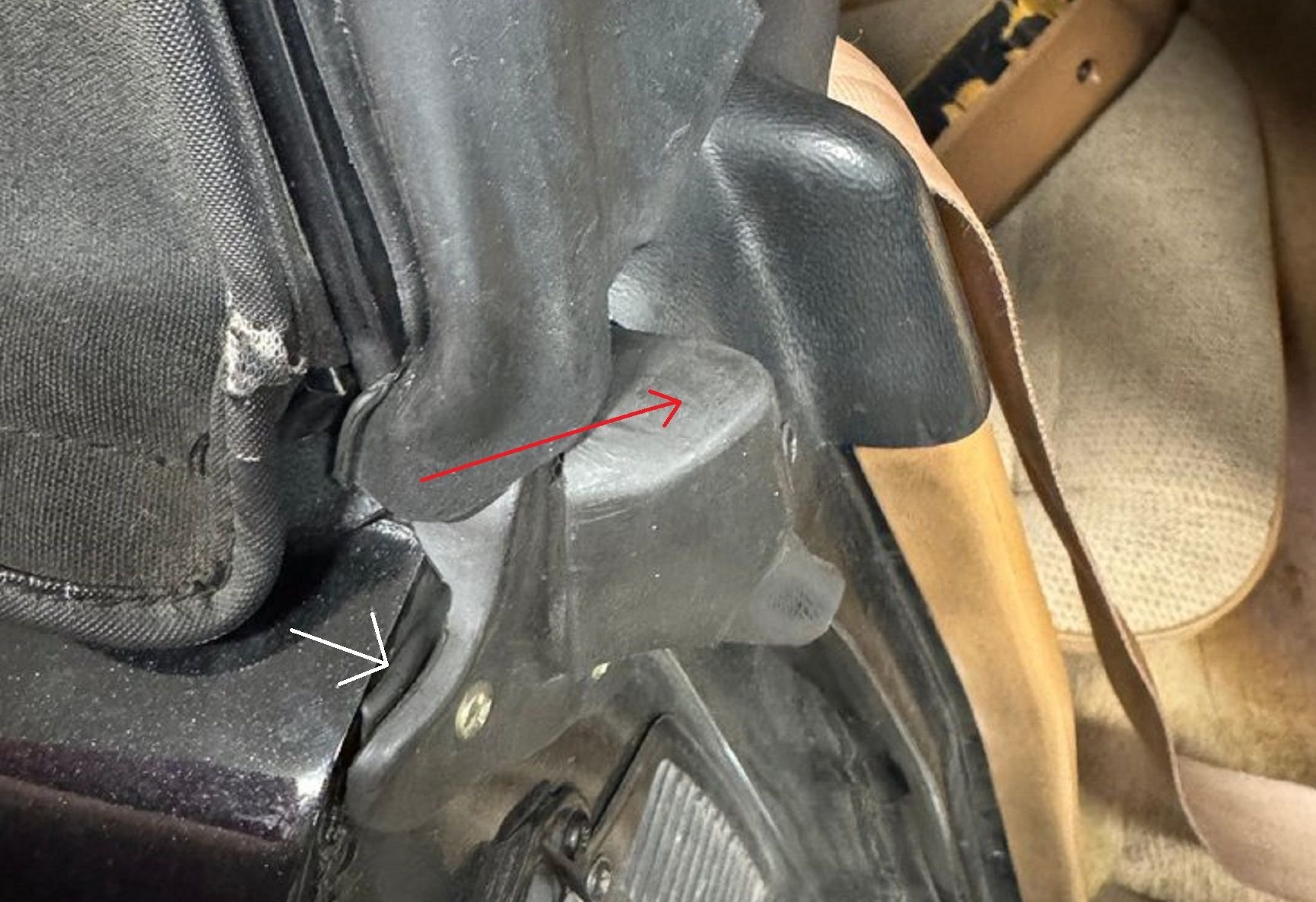

This is the gap I’m having problems with but I believe the vertical seal is not sitting right at the bottom if I compare with drivers side.
Vertical seal is not sitting right and not mating with the rubber block , compared to drivers side in next pic.
Drivers side.
Drivers side.

Originally Posted by Gnm62
Something is off there.
What is behind the small corner seal?
Also what is twisting the widow seal at the bottom?
Is there old weather strip under both seals. If so it needs to be cleaned out.

The problem is mostly related to that seal twisting at the bottom, more than the door sticking out at the top.
