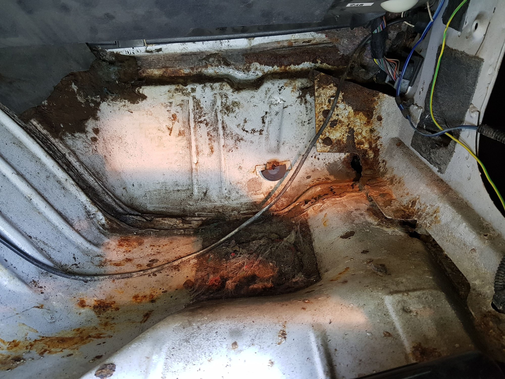

Old Nov 13, 2017 | 05:06 PM
Dominic1986's Avatar
Joined: Oct 2017
Posts: 8
Re: Convertible removing the Original Subframes
At first First, I have to remove rust and weld the Car.
Here a Picture inside the Car.
Old Nov 13, 2017 | 06:03 PM

You've got some work there!
