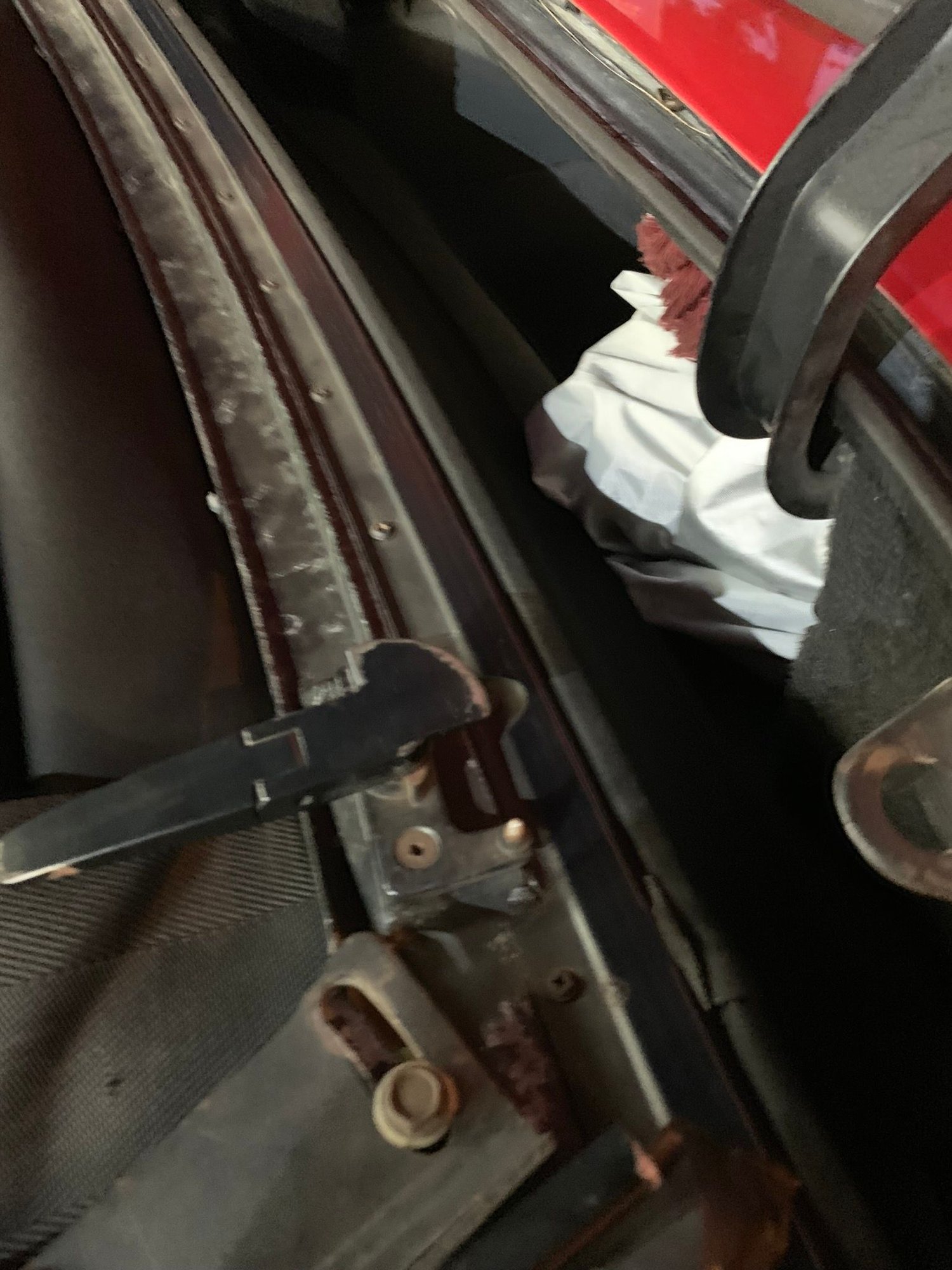

Thanks I will check it out. Here's a lousy pic. I'll put up better ones tomorrow. The front pins are about 1/4" long.

1/4" sounds too short.I think mine are closer to 1/2 inch.Are you sure the rear latch was/is completely in the closed position when the pin pops?

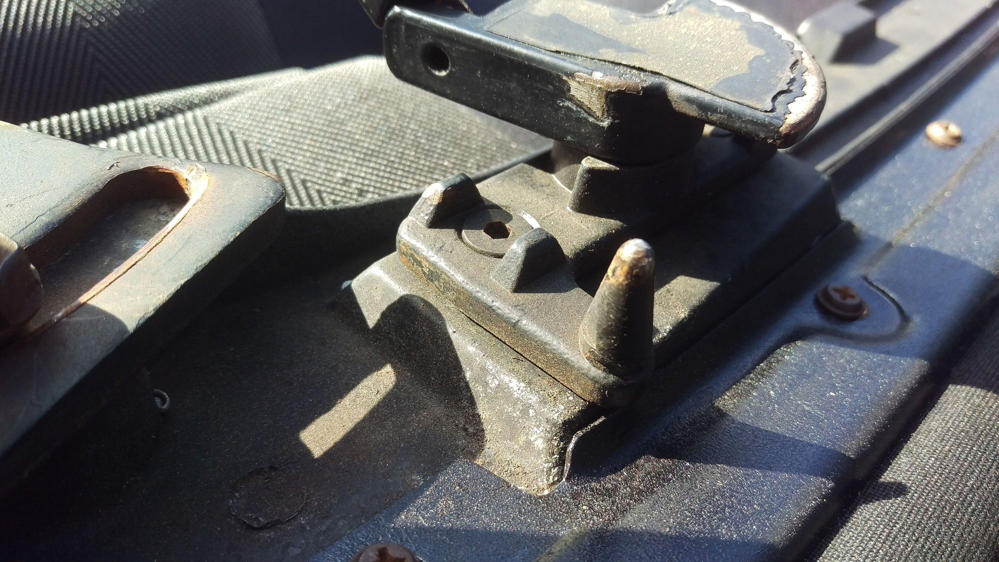

I just looked at my pins and they are like 841LE says and mine are like 3/4 long and tapered like a cone.

I looked at mine & definitely more like 3/4".

When I got My 89 iroc vert the front latches had very short pins like 1/4 inch.I didn't like those so I swapped in a set with the longer pins as shown above.
