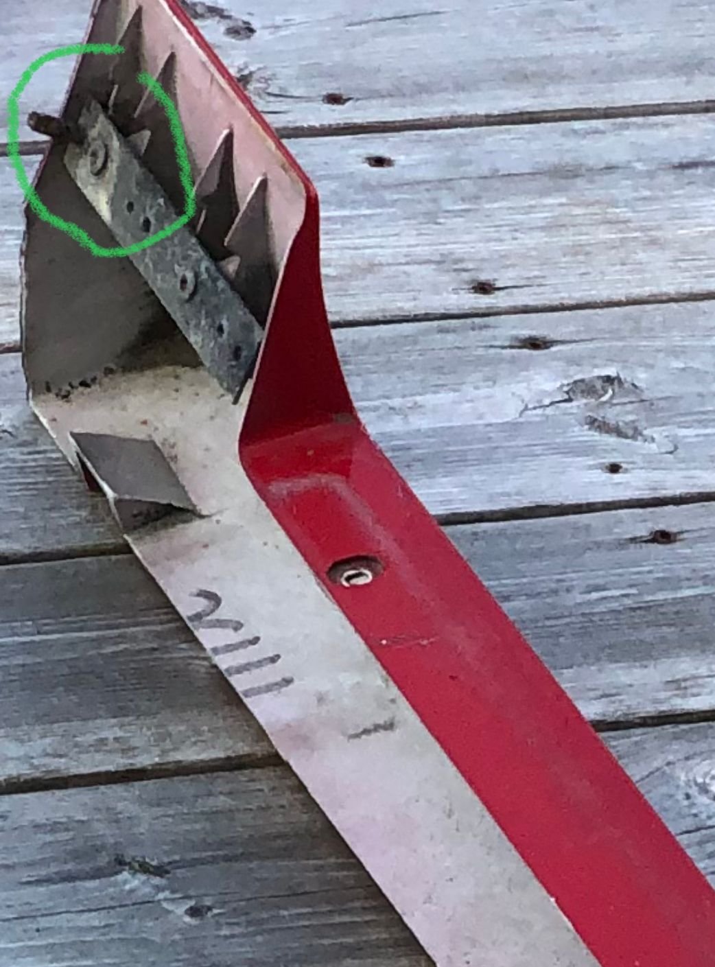

Not sure if this was done the same way on a car as late as 92, but on my 86 this bolt was relocated a couple of inches to just inside the wheel well instead of inside the quarter panel. Hope that helps.
Attached is a pic of the inside of the bracket on mine, showing how it was moved closed to the back edge.
Ken

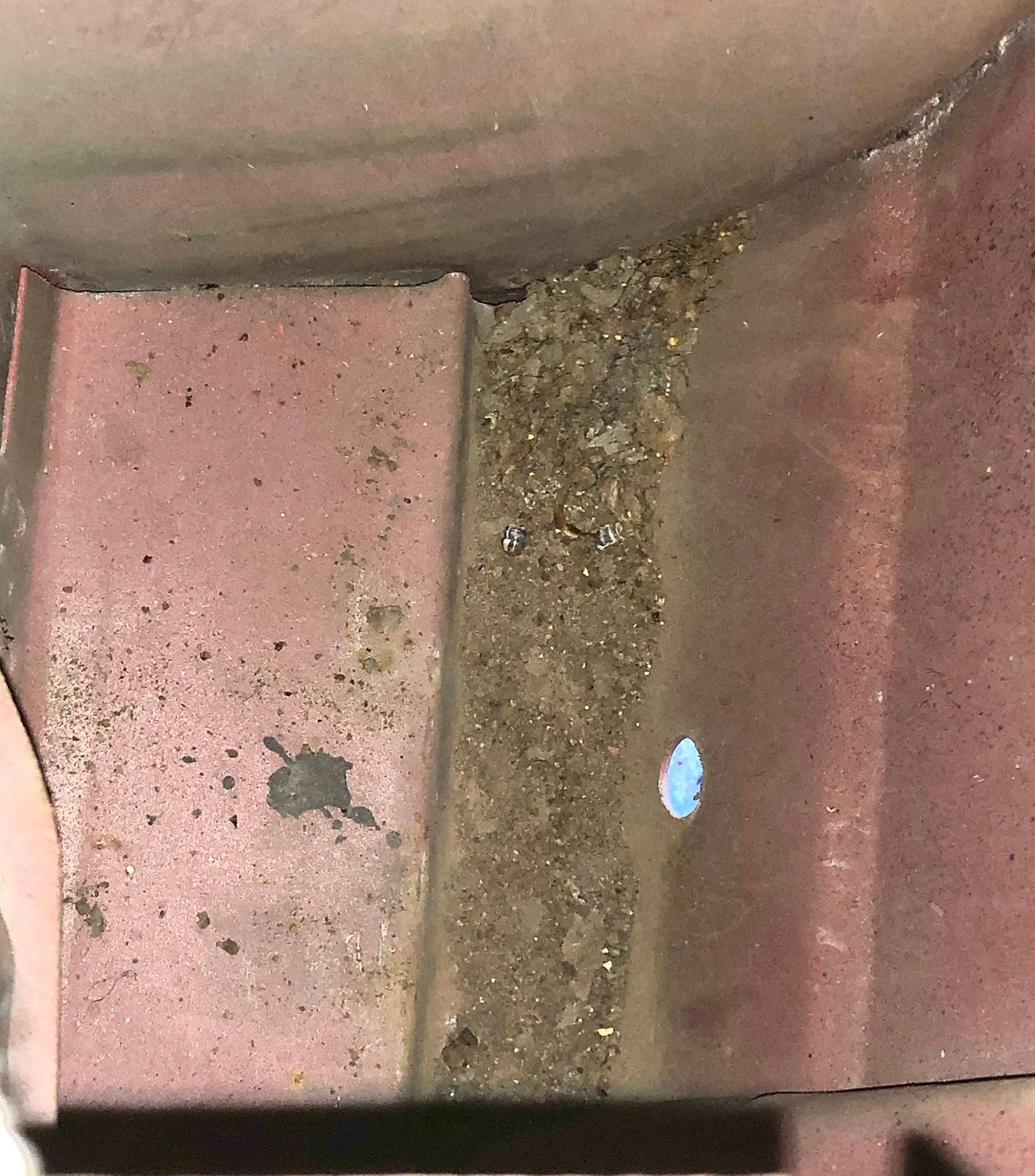

However, you should be able to at least verify that the nut is there by removing the vent in the door jamb. I stuck my phone in there to take a pic, an actually got my arm in there far enough to pick up a piece of tubing that had fallen off at some point.
So, it is probably tricky, but it should be possible to get to it and losen it from the vent.
