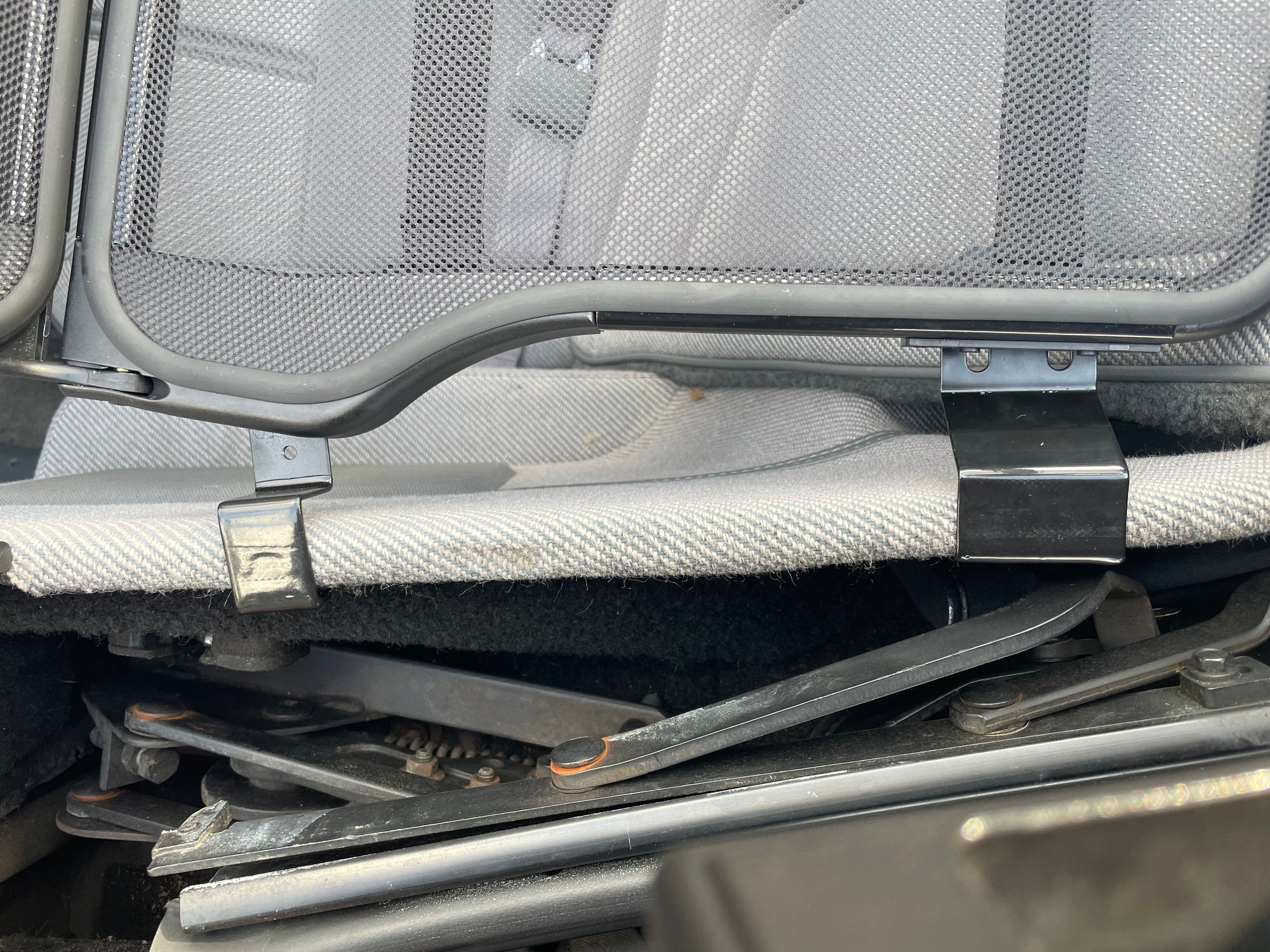

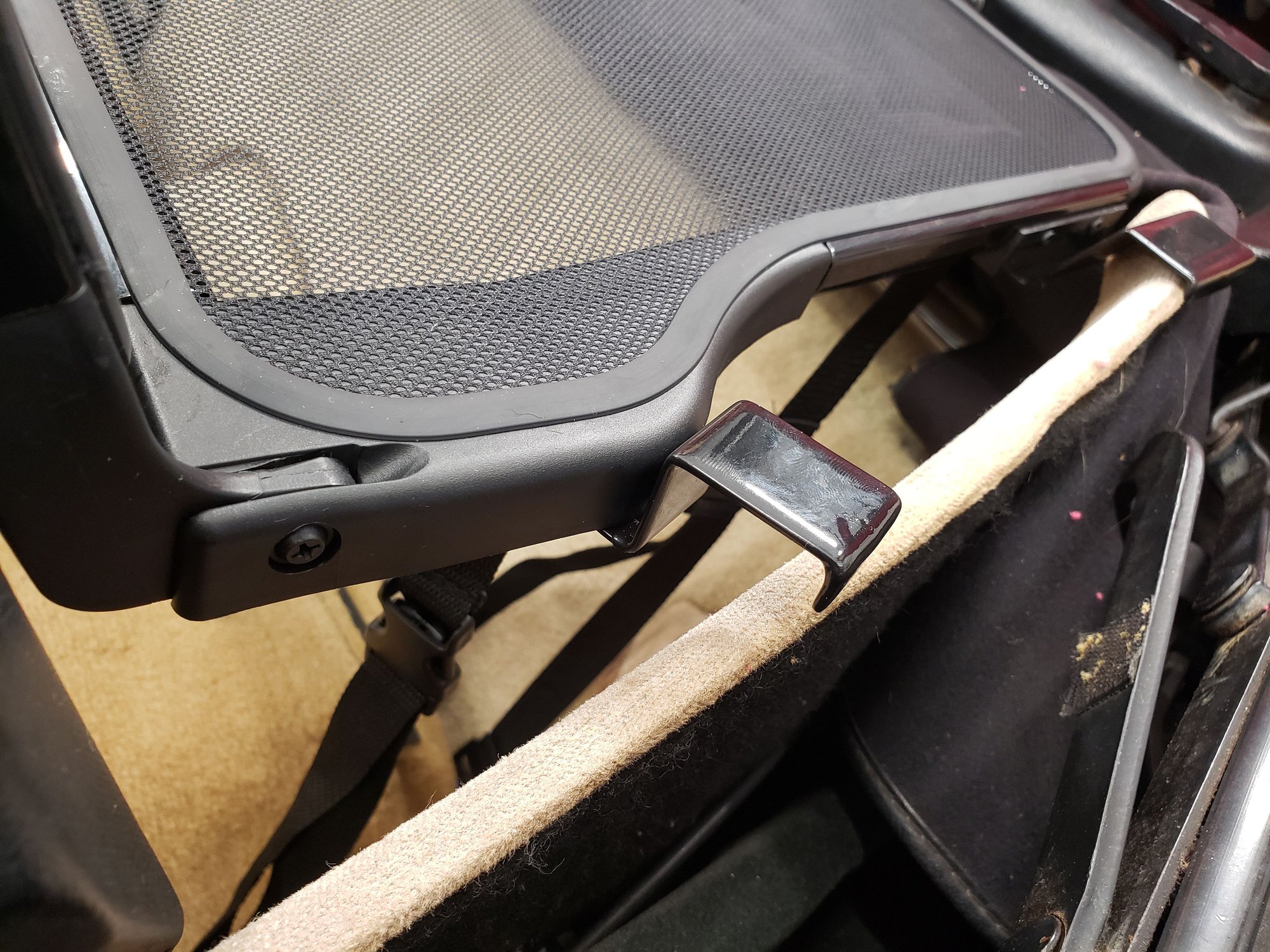

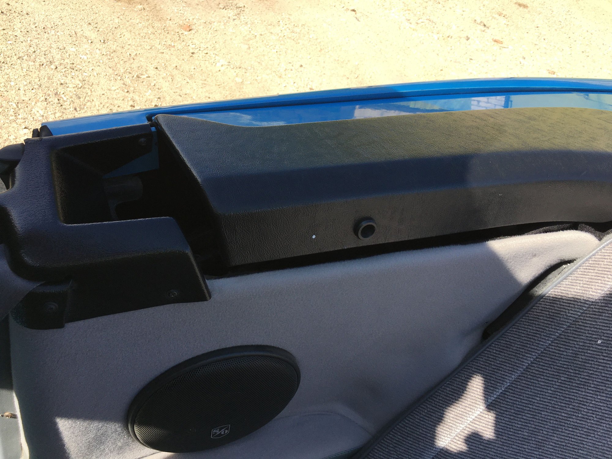

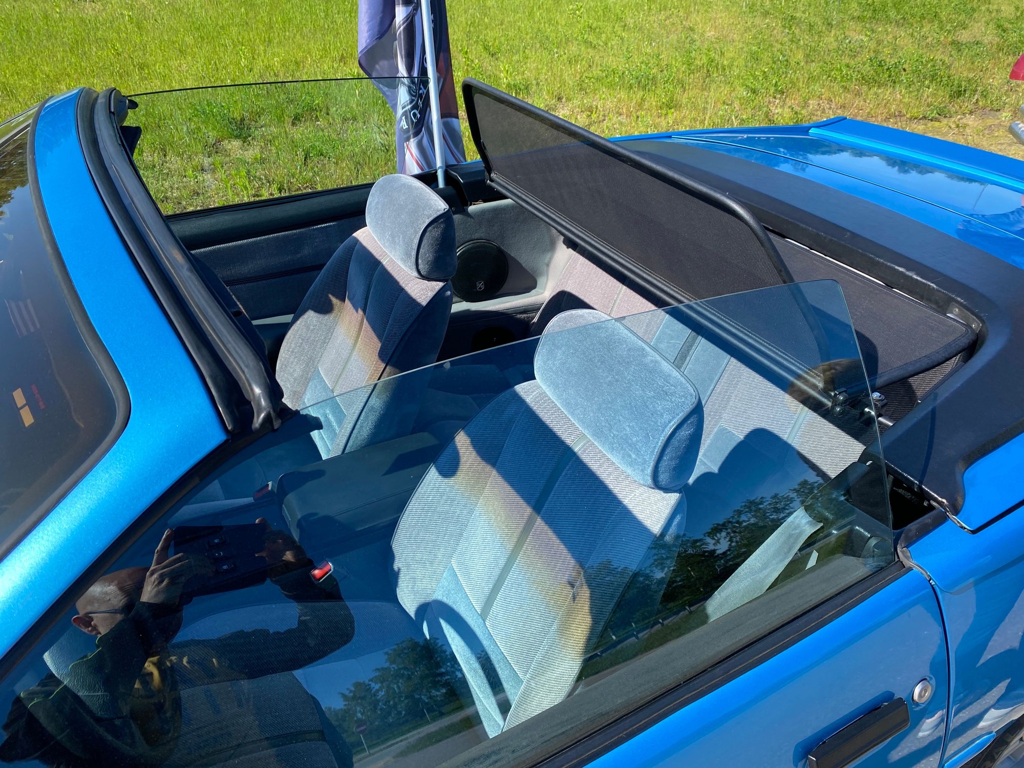

I made the purchase and before I installed it on my '02 SS, I test fit it on my '89 GTA. It fits pretty well except for a subtle mismatch of the contours around the tops of each rear side panel. I feel like with tweak of the front mounting bracket geometry this wind screen may be something I would consider on my '89 GTA.
My '89 GTA does have a light bar, which I believe may increase the back draft with the top down. As opposed to my '02 SS with the top down the back draft on the '89 GTA does seem more noticeable.
I've put a picture here of the fitment on my '89 GTA. I've also reached out to the vendor to see if they would be interested enough to rework the front brackets.
Let me know what you all think.
Thanks!
Gerry-
Front of the screen is lifted up a bit to align with my light bar.
Extending the 'reach' of this bracket would make fitment a bit better.

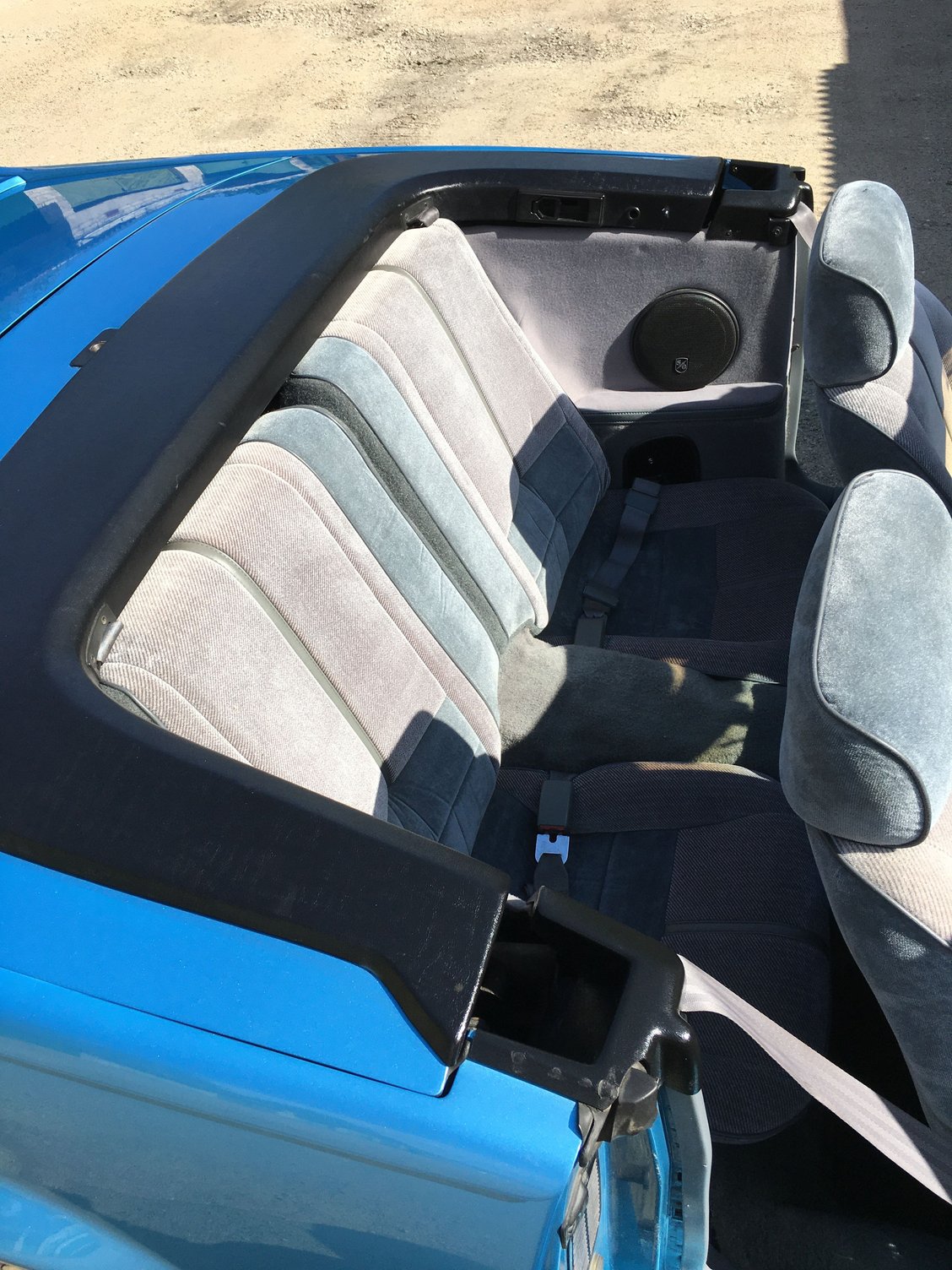

Figured I would post a picture of the fitment on my '02 SS so you can see the subtle difference in the contour around the top of the rear side panels.
Fitment on my '02 SS

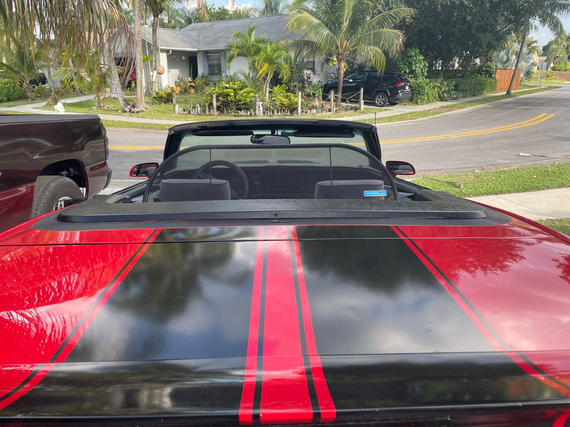

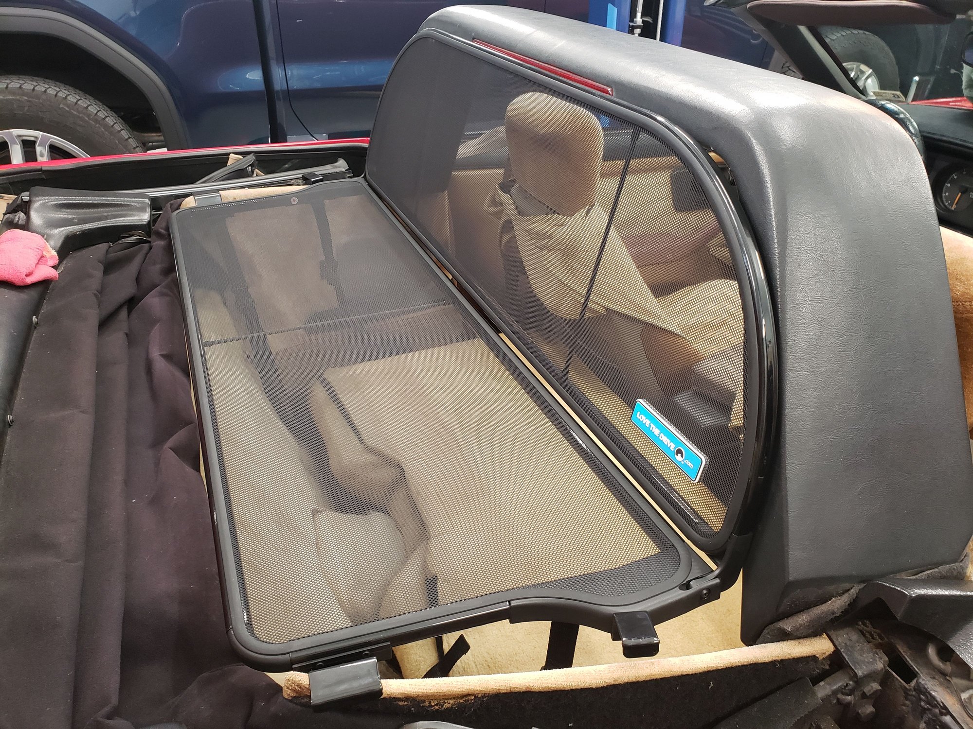

John, it closes well. In this case I lowered the wind screen a bit (i.e. does not align with the light bar). In that position the front brackets are still a tad short, i.e. I have to pull the top of the rear panel over a bit to engage the mounts. ( edit: If I did not have the light bar... I think this is an okay fit as provided by the vendor. Longer mounts would be a plus though. )
I am going to put this on my '89 today and take it for a spin. Its on the 02 SS at the moment, but its a QUICK swap.
With the Tonneau cover down and locked.

Looks a little off with the light bar (as it doesn't follow the contour) but seems to fit otherwise. I contacted them a bout making one specifically for the third gen and they wouldn't even entertain it. I asked if it would be a minimum number order but was blown off like they couldn't be bothered.
I might order a 4th gen and test it out.

Looking at the brackets, looks like they could be easily changed out to fit a little better on the side upholstery...

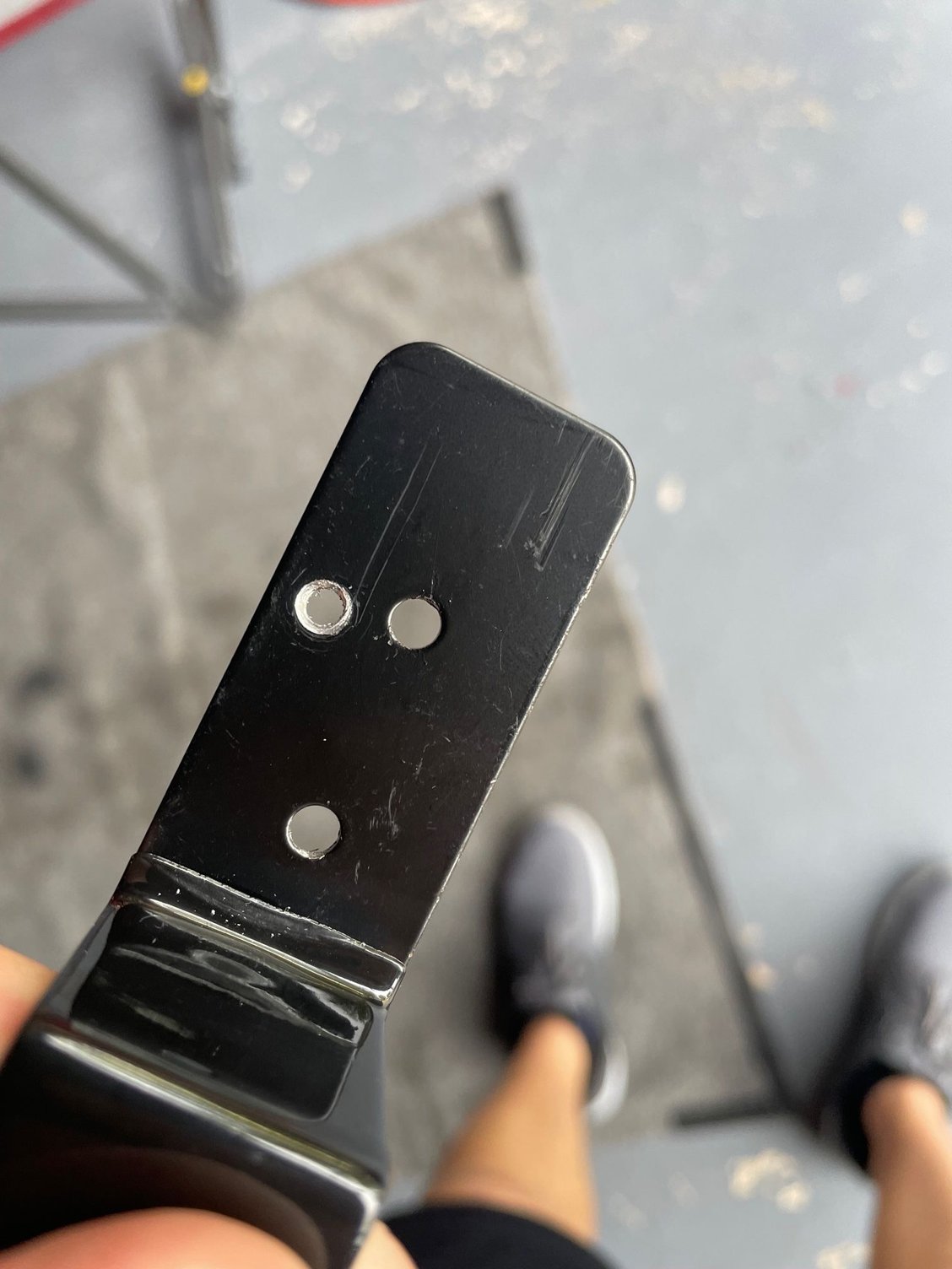

The light bar does impact fitment and perhaps to some degree looks. Functionality is what I am looking for, i.e. how well does it reduce the back draft while cruising with the top down. If it offers significant reduction I'll be looking for a way to mount it a bit better on my GTA. Mounting this to the tonneau cover. could be an option John.. The way it mounts in my '02 is quite simple and allows for quick install and quicker removal.
From my perspective I believe the front and rear mounts being a bit longer on each side would allow it to simply sit down and rest on the side panels like it does on my '02. As they are I needed to pull the top of the rear side panels in quite a bit to get the brackets to rest on the top of those panels. Sort of a 'force fit' until I tighten the hold down straps. Not ideal. On my 4th gen the 4 brackets sit down exactly on the top of the side panels, i.e with no pulling over on the top of the panel. Much better I believe.
Some seat time with it in place on my '89 GTA will impact my decision. If it is effective at reducing back draft/flow that will add weight to making a decision. Add improved fitting brackets and I'd be in.
Jimmylev I emailed a write up with pictures to a staff member for the vendor. Perhaps that will sway them? They replied thanking me and said they are forwarding the pictures I sent to the 'owner'. Whatever feedback I get from that person I will certainly post back here.

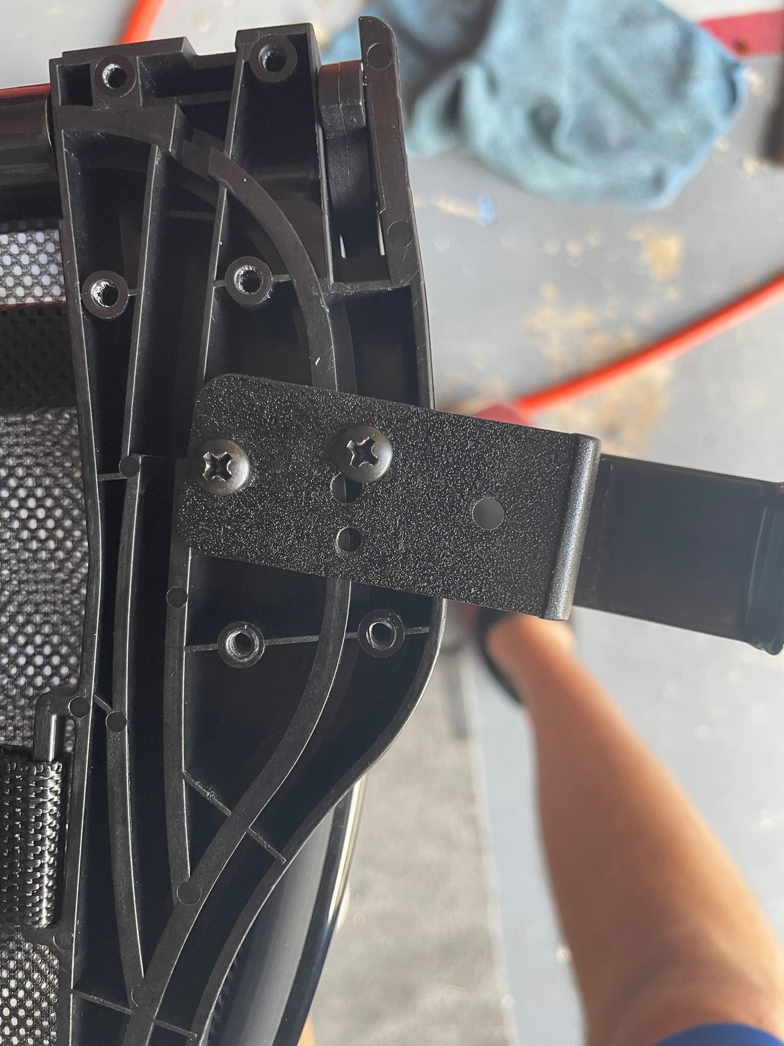

If they won't make a different bracket for third gen's, I think if you put some velcro strips like in this picture and than had a longer piece of velcro to connect to both of them would help keep it in place. This would allow you to use it on both cars.

Don't hold your breath on hearing back. They basically hung up on me when I asked. From memory, I asked about it, they said they don't make on for our model. I asked if they would consider if there was a min. order and the lady said we don't make one and have no plans to, then hung up.
Now, if I recall correctly, there was a spot on the site where you could submit measurements and they would see if one they currently made would fit.

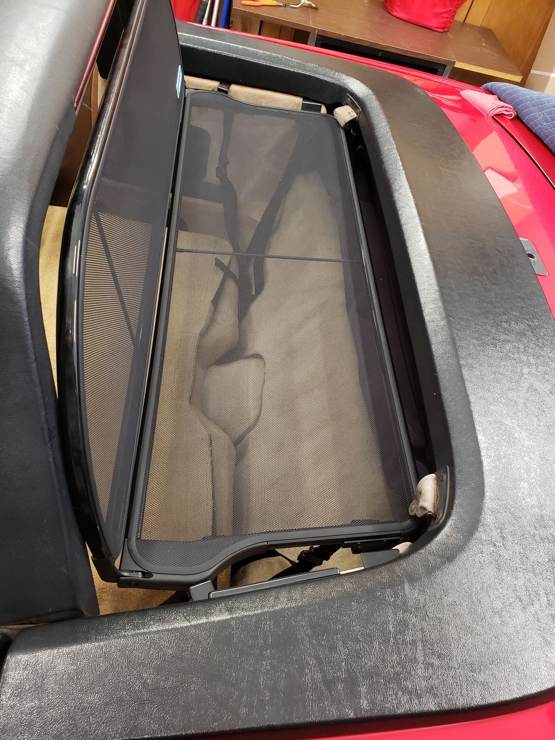

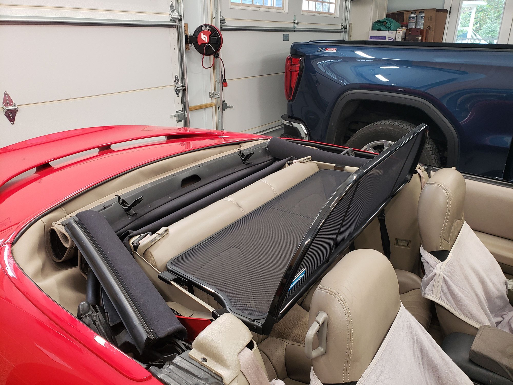

After moving this wind screen back and forth a few times between my '89 GTA and '02 Camaro... I have decided to purchase another one so they can both just stay put. For my '89 I just pull the top of the 'door' panel over and snug it down. On the '02 it just sits right down, no need to pull the top of the 'door' panel over. My original caveat that my light bar was the main reason this was not a better fit.. .looks to be valid to a point. With no light bar this most likely is a more acceptable fitment right out of the box. The contour of the horizontal screen is still not quite ideal (see my picture above) but that does not seem to impact the performance based on driving it in both a 3rd and 4th Gen. This still needs to be mounted back further on the 3rd Gen than on a 4th.... to allow the brackets to sit on the door panel top. But sitting down and back and snugged in with the straps... it does not move.
Bottom line for me is this screen works well to quiet things down. More normal conversation levels are possible and it keeps my navigator wife's tinnitus from flaring up. The vendor says 75% less wind and I have to admit it could be that much. Pretty much my 89 stays parked in the garage for cold or wet weather and I do not put the top up. Power top on the '02 makes it cake... just push the button!! You can leave this installed and both tops can go UP just fine. This is something I should have done years ago. I will post a couple more pictures of the final positioning.
Thanks for all the commentary! Hope this helps some to understand this product better despite the vendor saying '4th Gen' only. If anyone purchases this for their 3rd Gen and does not have the light bar, post back?

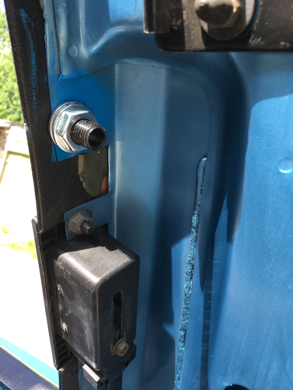

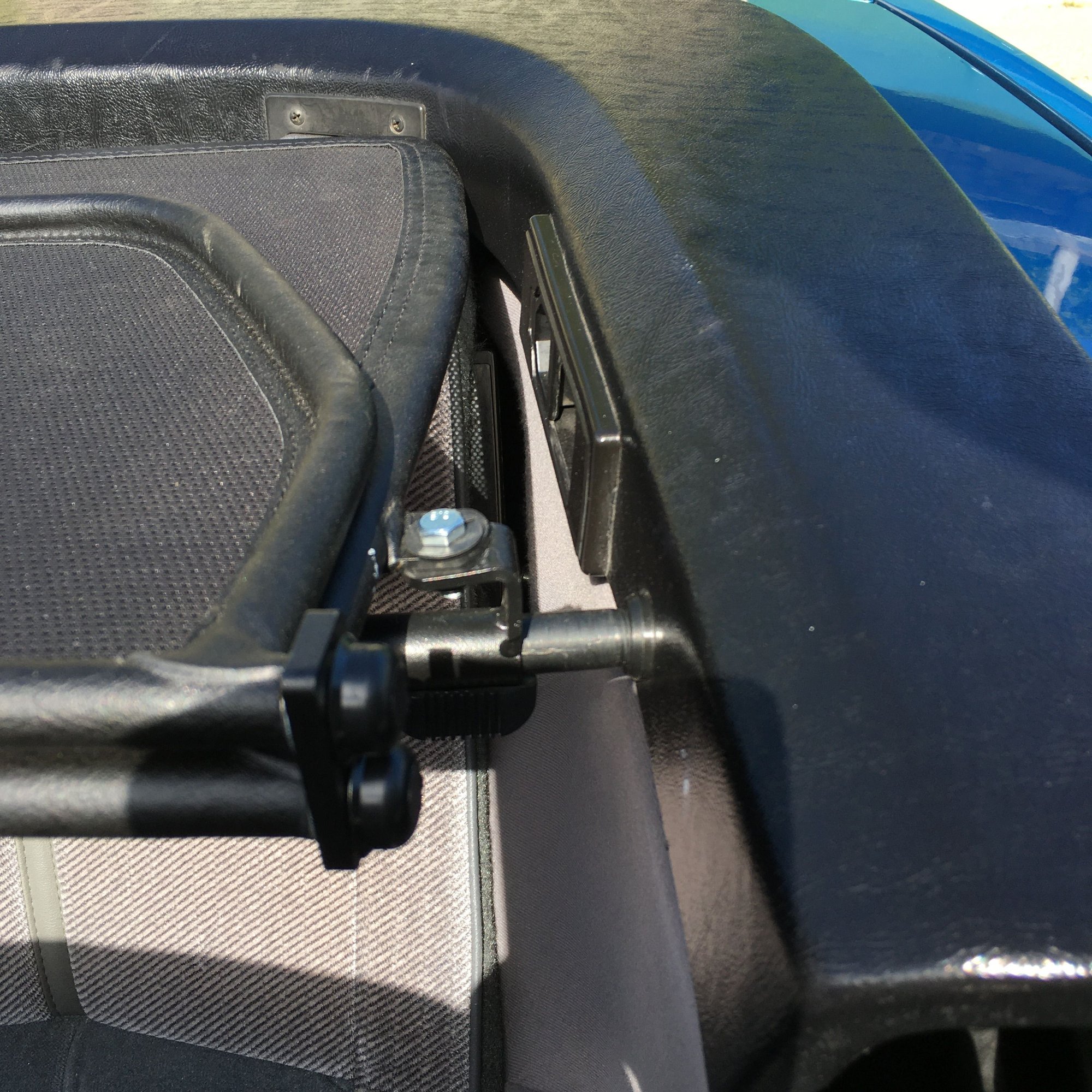

Here are a couple of additional pictures.
This sits back further because of the light bar, and in fact will likely have to sit almost this far back without the light bar... unless you make new brackets.
With the tonneau lid down, this is how it looks. I ended up having the vertical screen at an angle somewhat paralllel to the light bar. I also attached a small piece of flexible foam weather strip between the light bar and the screen to keep the two from making any noise on bumps or chassis flex's.

Can't be that hard to make one. It be easier to start from scratch, so you can bend/shape the bar to fit the 3rd gen, than waiting for that manufacturer to change this minds.

Yes, I think at this point that is a good option. This thing works well and an extended bracket would be straight forward to fabricate. Or... install it as is, just a little further back.

The brackets that are supplied have some adjustment in them. My light bar was a unique impediment to the install but without one your setup will likely be a piece of cake.
THE outcome of installing this is that my wife and I can now easily hold a conversation because the swirling winds are mostly tamed by this screen. Another benefit is cruising with the top down in cooler weather feels a tad less cool in the cockpit. Hair ties and hats for my wife are not needed as much.

I have and I also have not installed it yet. I am modifying the brackets so that don't pull in on the side panels just as gerrym said they would. I like it, it is nicely finished and light weight.
I should be able to use the brackets that come with it. I want it to fit with the seat up so i adjusted the rear brackets all the way out but still had to vice bend them and change the angle to get a further reach as the side panels get further apart the closer you get to the front. I am working on the new hole layout for the front brackets as they look to be long enough as you need a good 3/4" or better extension. I will also move them closer to the front. You can see the different bracket mounting locations from the pick.
Hoping to finish it up tomorrow and I will post picks of the finished product.

I got the windscreen installed to my liking. It drops right on top of the side panels without pulling the side panels in. Slam the tanau cover and off you go! I was able to just redrill 2 new holes in the front brackets and that worked perfect. This thing does work as advertised. From 45 mph down it pretty much blocks 95%. I think my truck with the side windows down has more wind and is louder than the car now. Once you get above 45 mph you do start to get the wind but it is so much reduced from before. Even at 75mph cruising on the highway it is sooo much better. I rolled the windows up when doing this and wow, almost no wind at all, you can hear the wind whipping behind the screen but the cabin is quiet and only a small amount of wind gets blown in from the back. Money well spent! The wife was amazed on how well this worked and just as gerrym said she needed no hat or hair ties in town.
I am thinking of cutting the tie downs off, i don't like the way the look and are not needed on our 3rd gen as when the cover is down that thing is locked in.
Gerrym, did you cut yours off or just leave them, i think I read where you purchased one for your bird?

I left tie downs on. I did not consider removing them but clearly on the 3rd gen the cover does sit right on them. Hmmm....
I did purchase a 2nd one for my GTA. It works great.

Hello everyone. I put a windshield from 4gen Z28 on my 3gen. Fits very well, it only took one hour to install. Works great and looks great.
