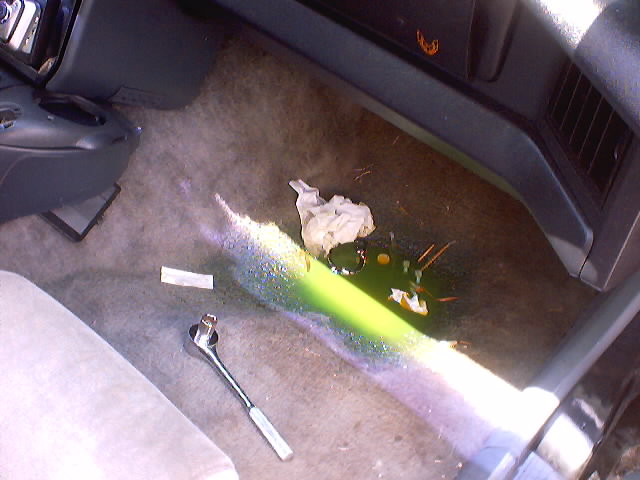

Ok Guys,
i was overheating and i went and got a 25 dollar cooling check at pepboys, i get back theres a puddle, and they say its my heater core so i grab a new one and i do the duty to save myself the 820 dollas they wanted to charge me,
the radiator cap seems to be working, the thermo was replaced shortly, im not sure if they flipped it upside down during the "inspection"
the thing idles and doesnt over heat after i replaced the core, so then i say lets try ac to see if it overheats, (it did before) it didnt at idle, so no probs,
but then i drove down the street and she overheated and overflowed into overfill and was bubbling,
ug i hate this,
My temp gauge doesnt work,
could that be something? could it be another sensor?
any other ideas bros? and could it really be a needed flush because i know its clean, and the water pump works, i took off cap, started car and then i saw it flowing.
thanx,

Check out my reply to Chronic Overheating . Hey that picture looks like my car about a month ago
