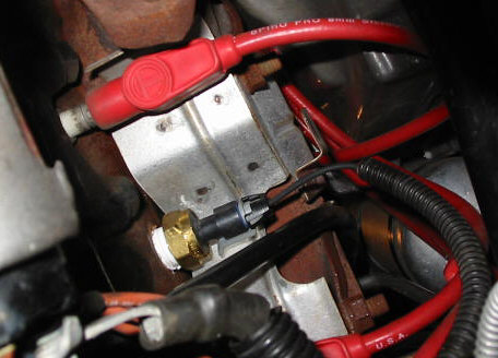

Hey man, I cant help ya too much but....
Your gonna have to go underneath the car.
And heres a pic for ya...

yup, theres very little doubt its the fan switch. Had to change it on mine a year ago. Gotta go under the car and get to hit like Iroc said.

That picture is great, but if you need a description then it's between plugs 2 and 4 above the starter motor. The knock sensor kind of looks similar but it's not nearly as far up into the engine as the switch. You'll know you have the switch when you unscrew it and coolant comes out. If no coolant comes out then you have the knock sensor. You definitely need to jack up the car for this one.

That picture posted by IROCTHE5.7L is my 91 RS's Jet-Fan Switch I posted awhile back. Are you sure your car is a 91?
