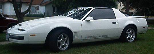

ramair350's Avatar
Posts: 108
From: Omaha, NE
My 89 Formula 350 never gets that hot. The only time that it even gets up to 200 is when I was idleing in a parade! My water pump and fans are bone stock. The only upgrade that I did was put in a 160 thermostat. Iven in the 95 degree plus days that we have hade around here (Iowa) it doesn't get that hot with the AC running and me doing 75 to 80 mph on the back roads it never got that hot!
