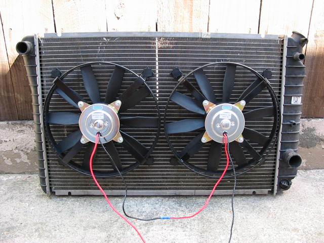

Installing a fan in front of the radiator to push the air through is very inefficient. If you don't already have dual fans try installing another fan behind the radiator. Electric fans work best installed as Puller fans. Dual fans cool the radiator a lot better than the Single fan.

Here's a picture of my dual 12" "Perma Cool" fans installed.
so how do u have that setup and whats the stock number
do both fans turn on at the same time or do u have a manual switch for either switch?
on this setup, what did u do with the fan/radiator braket....
I ordered the fans from www.summitracing.com part #PRM-19008-P3P $82.95 each. I just wired both fans together + to + and - to - and then connected them to the stock wires that went to my original single fan. I had to trim part of the stock shroud for clearance as you can see here.
one other question.... with the way u set it up...is it safe, its not gonna blow relays or fuses?
o yea i forgot to ask last time, how big is your radiator??
Both fans together only draw 15 amps and the stock fuse is a 20 amp so I figured it would be alright. Also, another member here (forgot his user name) had his wired the same way for over 4 years and has no problems with it. The radiator is the stock 31"x 19" aluminum core with the plastic tanks.

GKK
In the pic with the radiator out it shows the fans wired in series. But the way you described it when mounted in the car was parallel (which is the correct way). So did you change the way it was wired between the 2 pics?
I have a dual flexlite set-up with both fans on full time now, but thinking of rewiring them so one fan on all time and the other comes on by thermostat or maybe both fans on by thermostat with manual override.

I was going to hook the fans up like in the picture but, realized later that the fans would not receive the proper voltage. I wired the fans + to + and - to -. Also, I wanted both fans to come on at the same time to cool my A/C condensor better.
