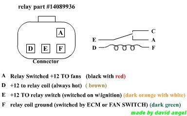

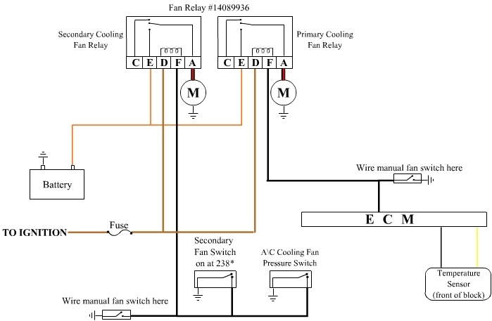

heres a diagram.. might need to recheck somethings.
