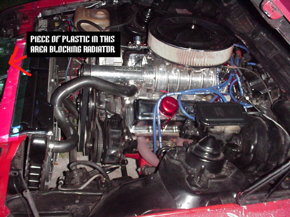

theres this piece of black plastic right in front of my radiator... it just kinda SITS there... lemme see if i have a pic...

that plastic piece kinda surronds the latching mechanism for the hood. it makes a great tray when working on the engine and also healps direct the fresh air towards the radiator more than over it. i wouldnt bother doing anything to the grill because even with the fogs it doesnt hurt the airflow much. i say leave it alone and it will look good. take everything out and it will look undone.

On my car, the hood sits ontop of that--how will moving air reach it? The nose isn't designed with enough openings to allow enough flow to keep the engine cool.
Old Jan 6, 2003 | 08:29 AM
89_3rd_gen's Avatar
Posts: 81
Since our cars where designed as a bottom breather you'll need to do some duct work. I think you can make it work (since the rad is vertical unlike say a corvett). Some ideals: close off open areas like: the bottom (were air come up now), keep the upper and side shrouds , extend the side ones to stop air bleeding out. You could even mount some small hoses off the side shrouds to bleed a small amount of the high pressure air for brake cooling or the some can be done on the top shroud for your intake. You can fab up some simple brackets from metal stock to regain support lost from the mods needed.

You'll have to remove that "plastic thing" it helps move the air off the ground level using low pressure. Also theres is that honeycomb stuff behind the middle of the nose, the metal bumper needs to be open'd up (plasma cutter/recipicating saw), keeping the horizontal parts intact (mount a oil cooler maybe there). Ideally from the grill opening to the radiator there is no way for the air to escape but thru the rad, thats the duct work issue. It's nice to control the heated air outlet too, but not needed for this application, goes out the bottom around your block, exhaust, oil pan which helps cooling.
Keep the air dam but cut till it dosen't touch (could be as small as 2" hanging down) it will help cause more low pressure behind the rad and pull more through a non sealed cowl induction hood.

oh, opps nvm... Thought you where going to pull apart the bumper. That plastic piece will be important if you run a cowl induction hood. All the air will be diverted into the engine area and away from the radiator becasue of the low pressure in the engine compartment.

Not having that plastic ductwork in the front in addition to that plastic cover could cause problems with a cowl because it will generate a region of low pressure in the engine compartment that could possibly draw a large ammount of air over the top of the radiator instead of through it. Ive found that the radiator posses alot of resistance to air passing through it so thats why gm has allt hat duct work and the air dam so that air is forcefully directed into the radiator. Your other option would be to close off the top area between the radiator support and the hood so that all the air would have to flow through the radiator and teh cow would actually help draw air in to cool the car.
