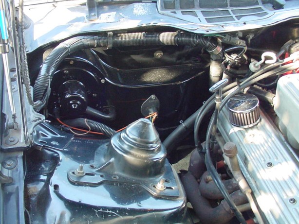

Ok guys................ have seen some posts on the 1LE delete pully and Non A/C airbox mods for taking your A/C out of your ride.....Can you guys post some pics of how it looks in your car after the A/C has been taken out and the 1LE pully put in with the A/C heater box..........would like to see some serpintine belt setups with this done........thanks......

Here ya go...
Attached Thumbnails 1LE delete pully-Non A/C airbox-nonac1.jpg

Your engine looks great....am gonna do the A/C pull on my 92 firebird and put in the delete pully, might be hard to find a Heater delete box......did the S-10 pick up truck come with it also along with certain camaro's and if so what years should i look for in the bone yard???......

you can get a box here
http://members.***.net/iroczdave1/IR...rts%20Page.htm

yeah IROCZZ3 your engine bay is great looking!! if mine looked like that i wouldnt mind putting headers on my car.. plenty of room.

Thanks guys...the link MdFormula350 posted is where I got my heater box. Great person to deal with!
I've heard the S10 box can be made to work with a little modification but I've never seen it done. Lately I've seen our heater boxes on ebay but beware, people have been paying way too much for them, and some of them don't even come with the blower motor. IROCZ Dave (where I got mine) included the motor, wiring harness, and mounting bolts for $88 shipped.

ZZ3 i just had a few questions about you're air intake tract. Is that the aluminum LT1 elbow out of Jegs? Also what is the connector between the elbow and the throttle body. Also I see that you have a MAF so what is sticking out of the side of that elbow. Finally is the MAF just a slip fit into that elbow or is something needed. Thanks for any info. -John
Yes that is the Vortech LT1 elbow turned upside down.
That blue thing? It's just a silicone hose coupling that came with the elbow.
It's a plug I pieced together for the MAT sensor hole but I might put a nitrous nozzle there instead.
Yes the MAF slip fits into the elbow. It's a VERY tight fit and there are no vacuum leaks so I didn't bother to use a hose coupling.
