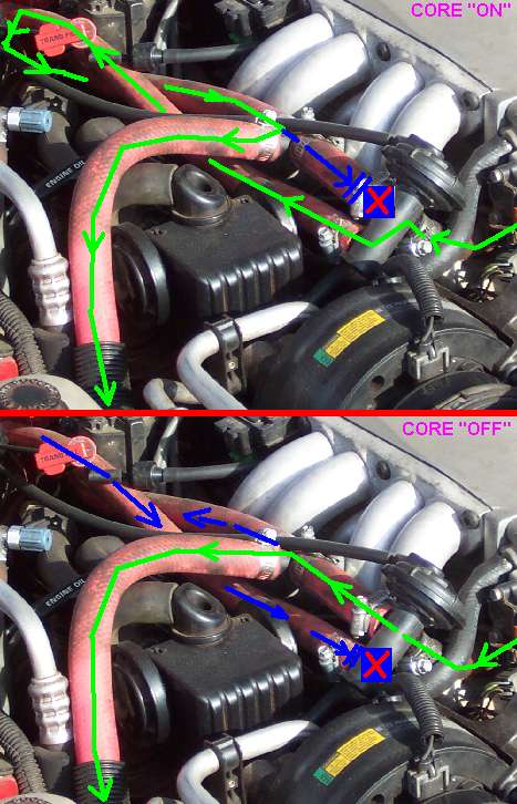

Old Feb 1, 2003 | 02:55 PM
patrickm00's Avatar
Posts: 435
ok, here's a quick flow overlay onto my system. the way the valve works is that it blocks either the upper or lower outlet (marked by the box with the X). coolant will always be in the core, but it won't be _flowing_ in one case because of where the flow will stagnate. so the T in mine is in a different physical location than it was before in the engine bay, but flow-wise it's in the same place (i.e. it looked a little different to me, but it used to be under the a/c lines, but still off the top hose. but the system hasn't changed)
basically, you can break in anywhere you want, but the manifold exit is the preferred location from a convenience standpoint, since it's about the same height as the core, and the radiator does more cooling, so it's better to draw from the radiator than the core to feed the engine, and put the core on the return when it's hotter coolant, since what you want is heat anyhow.
Old Feb 1, 2003 | 02:56 PM
patrickm00's Avatar
Posts: 435
the green and blue represent the coolant, green is flowing and blue is stopped by the valve.

also, it's important to T off the top hose coming off the valve, since the vacuum acutator won't work the other way (when you switch the control to 'heater' it will pull), and your heater/fan and core will be on at opposite times...
